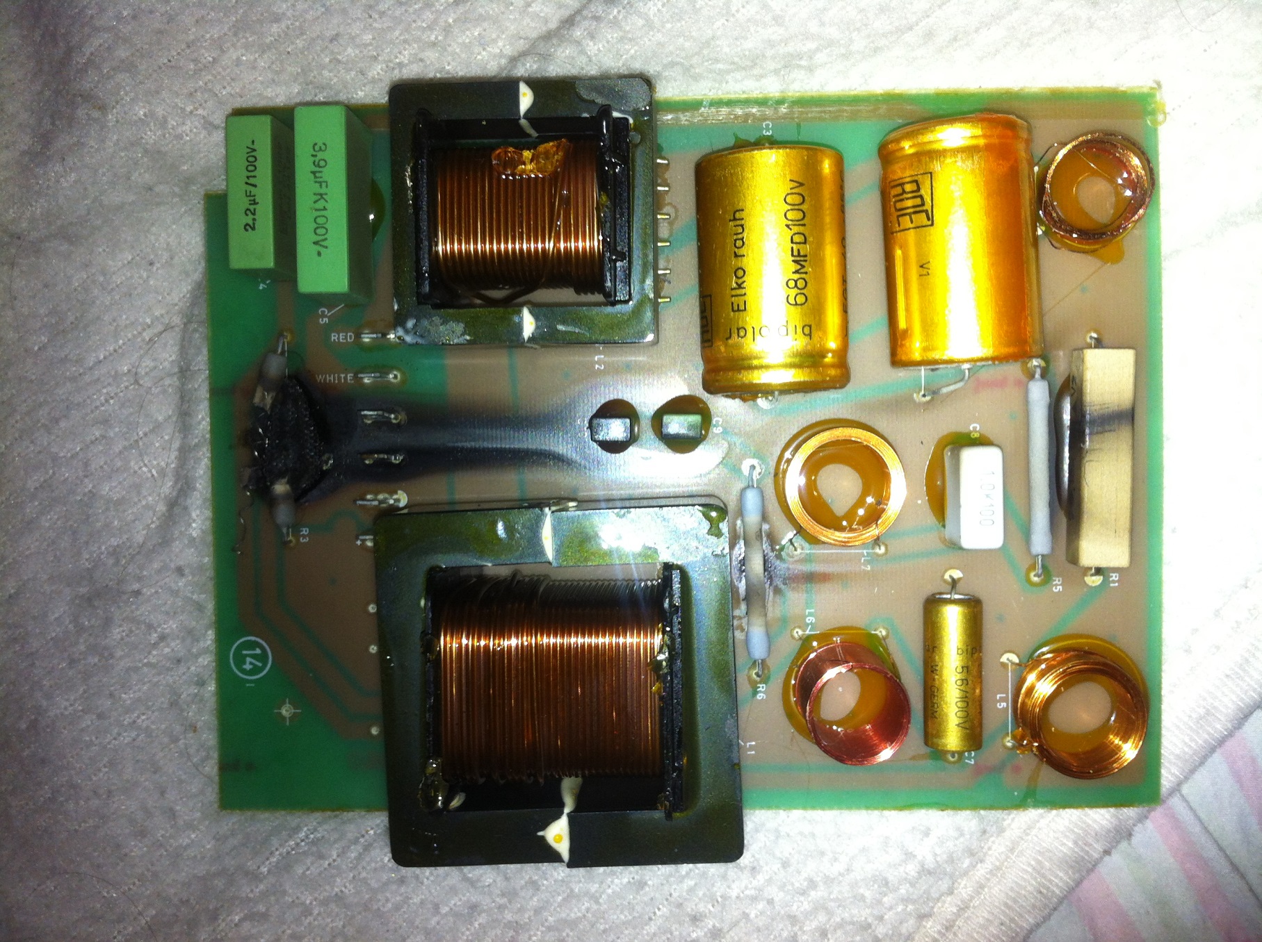

hello i don't have schematics for my boards and i don't know which capacitors , resistors and coil to order.
I was thinking to buy this capacitors :
Mundorf ECap70 68uF 70vd
Audyn Cap MKP polyprop. 5,6 uF/400V
Jantzen Cross cap MKP 8,2 uF/400V
Jantzen Cross cap MKP 22 uF/400V
Jantzen Cross cap MKP 27 uF/400 V
Is it ok that they are all 5%?
below i listed resistors , capacitors and coils which i don't know with what to replace.
BOARD 14:R1R2R3R4C9C10L4
Do i need to replace something else? and is it matter which way they are soldered to the board?Thanks
Hi there. Seems like some of the Experts are on vacation...
But have a look at this:
https://translate.google.com/translate?sl=da&tl=en&js=y&prev=_t&hl=da&ie=UTF-8&u=http%3A%2F%2Fwww.hifi4all.dk%2Fforum%2Fforum_posts.asp%3FTID%3D42140%26KW%3DB%2526O%26PN%3D0%26TPN%3D20&edit-text=
