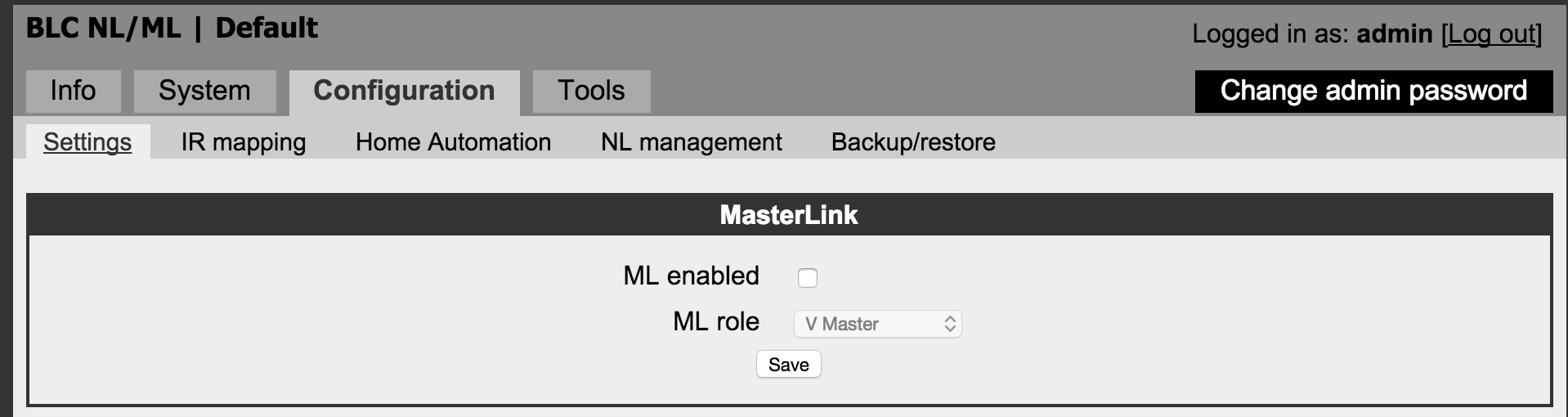

I'm not sure where I can do this. However, I re-checked my cabling all around and now the NL/ML is actually visible on my network and I can enter the Webserver using it.
Right now, MasterLink is disabled on it (see attachment). Also, if I do activate this, what role should it use?
Again, I'm not even sure if the NL/ML box is seeing the BeoSound5 system, but the BeoSound 5 and the 3500's are working.
Mike

mjmedlo replied on Thu, Dec 25 2014 5:07 PM
Click yes to enable the masterlink
And choose a.slave

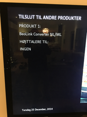

I've done this now and on my Avant under Product Integration, I now see the picture that is attached (sorry, my TV is in Danish!).
Should it say something under the option about "Speakers connected to"?
Also, now this is set up, how do I actually get the BeoSound 5 to play any music through the Avant?
Again, really sorry for the stupid questions from the B&O newbie here :-)

Guys! It works! I selected N.MUSIC under Music on the remote and the TV is now playing music of the BeoSound 5.
THANKS A LOT :-)
