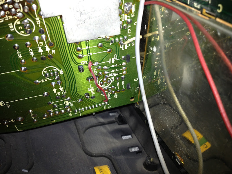

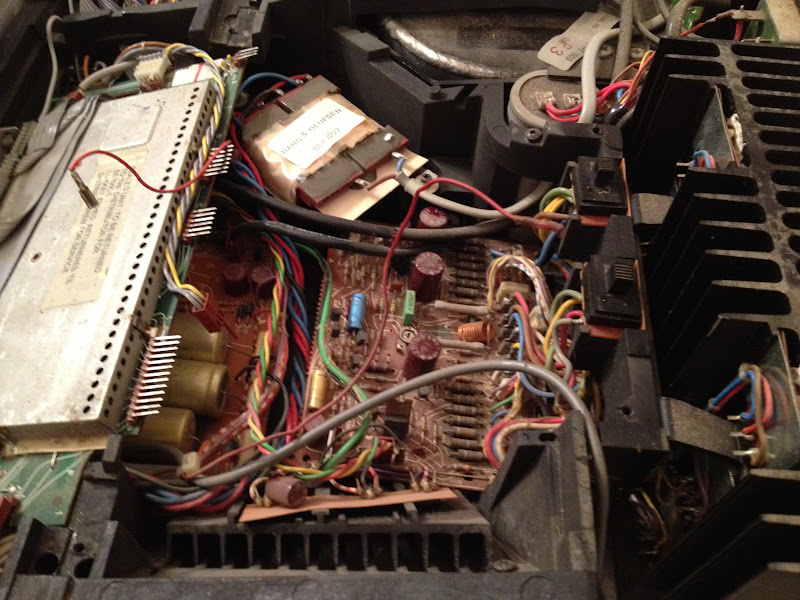

As for photos, I don't have any recent ones, but the CPU board is green. Here are the best I can dig up:
And another:

chartz replied on Sun, Mar 1 2015 10:20 AM
Hey Tom!
The CPU is the one in the tin can! This is a series 2 module which doesn't have the ground via problems. It is very difficult to open up, and unless you are a trained hobbyist (my little finger told me you are not quite there yet!) I'd advise you against doing so. The memory chip is in the can, and can fail. But it can be many things... Perhaps a bad contact somewhere?
What you show is the PSU/IR board!!
CPU = central processing unit
PSU = power supply unit
Jacques

trymes replied on Sun, Mar 1 2015 1:33 PM
Thanks, Jaques. I realized that one of the photos was the PSU, but I had an issue removing it on a mobile device.
i have no intentions of going into the CPU itself, but I have already replaced the red caps in those photos (they were old ones).
