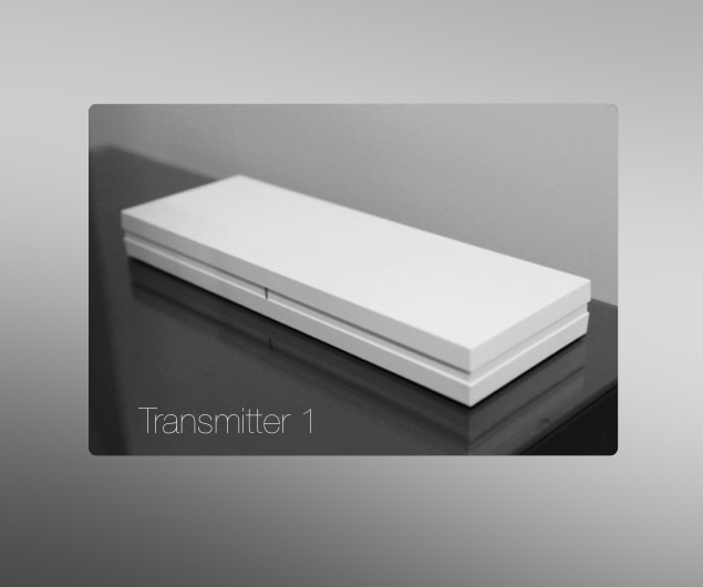

Can I connect a Beolab Transmitter to a Playmaker so I can enjoy music from my wired Beolab 3s in the living room, while also having music sent to a pair of wireless Beolab 17s in a bedroom?

But the music will play on both sets of speakers - unless you manually disconnect one of them from the mains.
You can't send sound from a Wireless 1 to the Playmaker - unless you connect a Receiver 1 to the line-in of it.
Which theoretically would work, but probably would be a bit complicated to manage in real life.

Correct. Currently, I have a Playmaker (Mk II) wired to a pair of Beolab 3s in my living room. I had this idea that maybe I could add a Transmitter to the Playmaker so that I could tranmit music to a pair of wireless Beolabs in the bedroom. I want different music on each speakers because I saw mention of wireless multi room on the Beisound Moment product page, but I'm thinking that's just for the Moment.

BillC:Hi Millemissen, I have the Beolab 18 and Beolab 3 hooked up to my HTPC for 4.1 audio. I wanted to know if I bought a Transmitter 1 to send the front audio to the Beolab 18 whether I can hook up the Beolab 3 to an existing Playmaker to receive the rear audio - that way I don't need to buy the receiver 1
You can't send the sound of the rear channels to the Playmaker wirelessly.
The Playmaker supports two wireless protocols: AirPlay and DLNA - neither can be used for what you want.
If you want to send sound to the Playmaker (from the rear-output of the HTPC), you will need a wired connection - and the connection from the PL of the Playmaker to the BeoLab 3 has to be wired too.
So why not just do as you do now?
