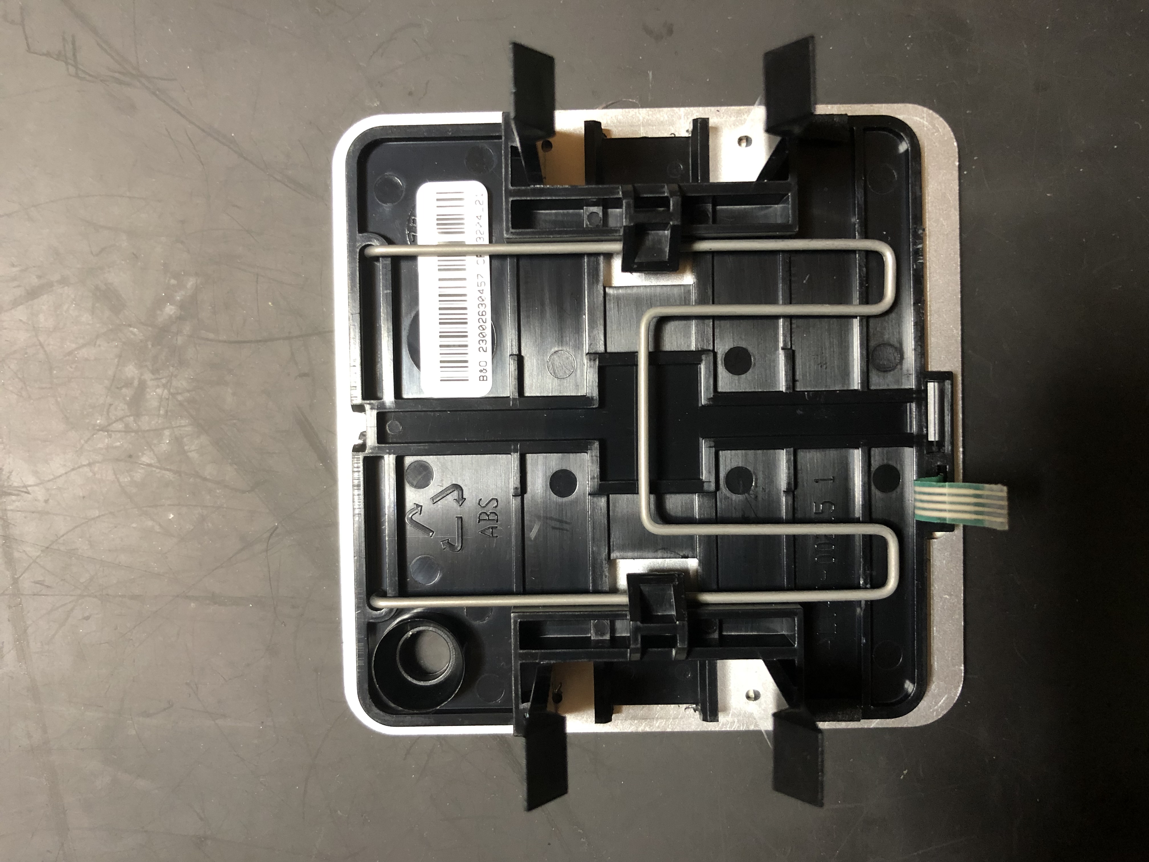

Biyo replied on Thu, Nov 8 2018 11:02 AM
Here is my back side of top panel. The left side of photo is the panel front side.  Center of steel spring crips to main body.
Biyo
Posts 2
Biyo replied on Thu, Nov 8 2018 11:05 AM
Sorry!
X: Left side of photo
o: Right side of photo
