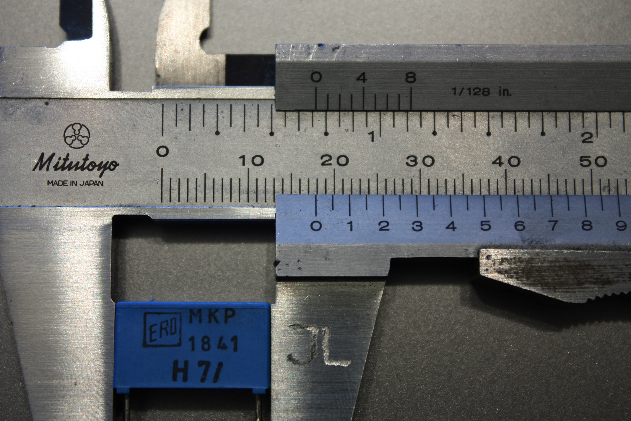

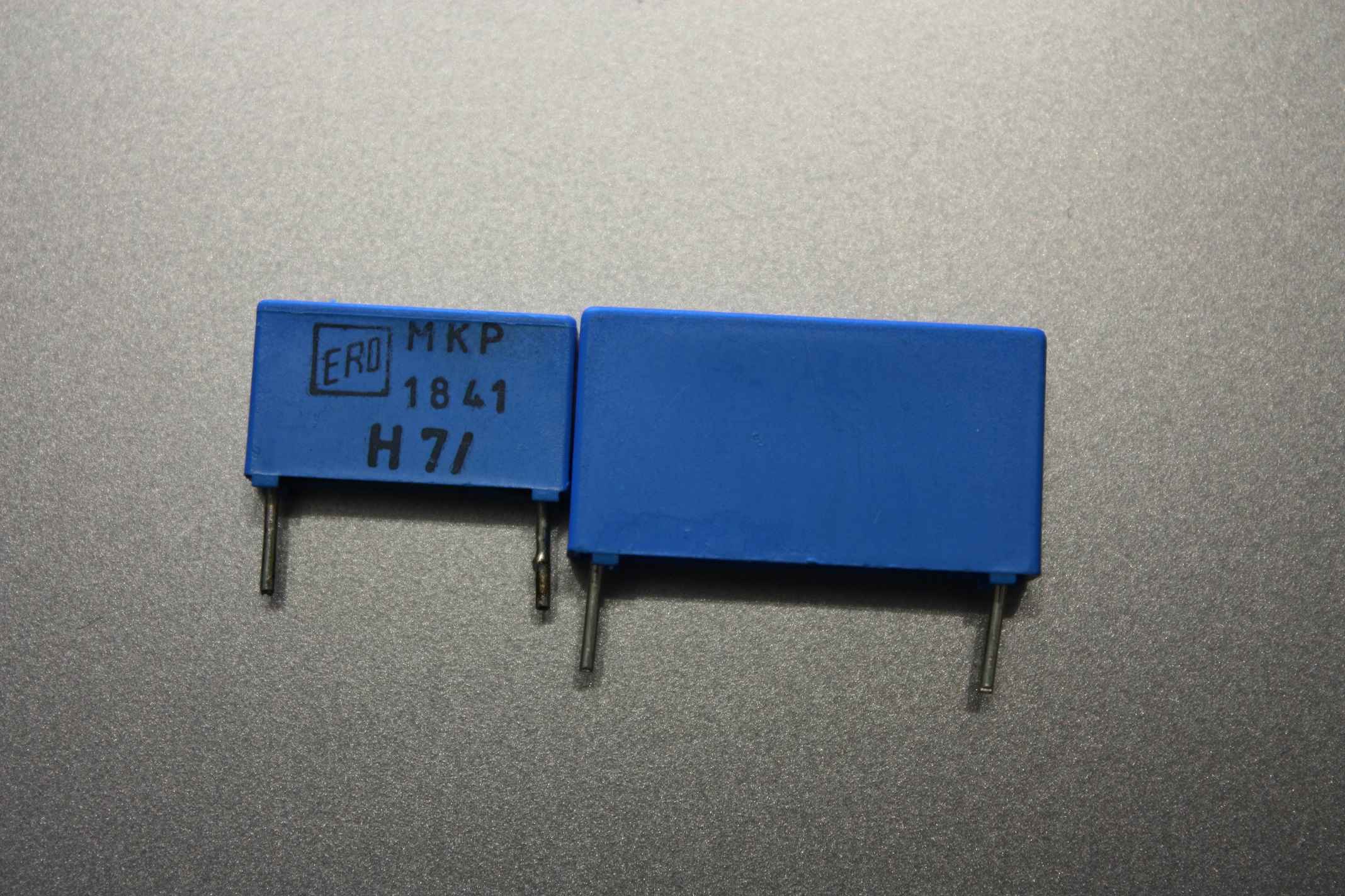

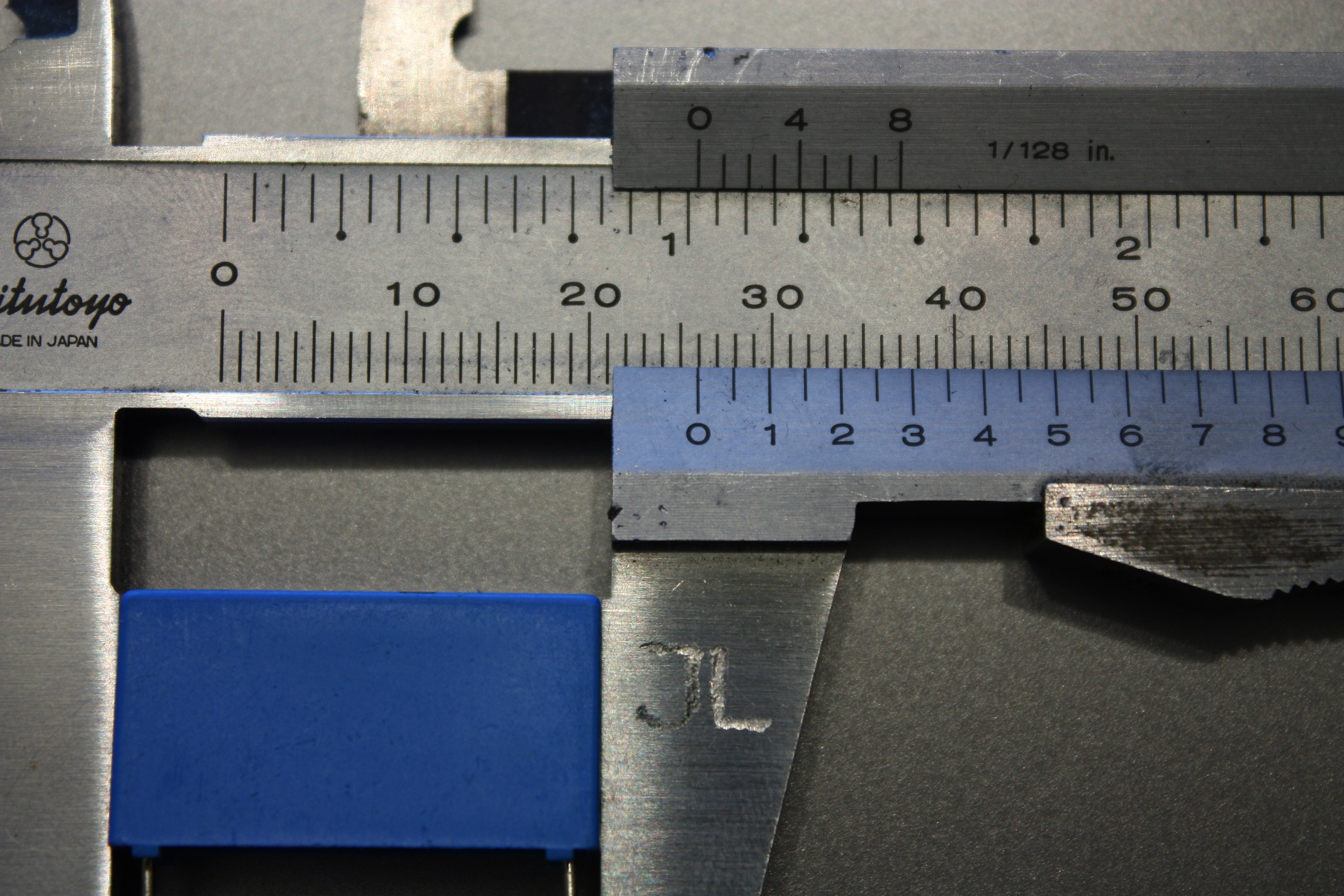

Welcome to Beoworld. One of my AV9000s had the same fault when I bought it about 4 years ago. Replacing C101 fixed the problem in my case. It's a blue capacitor found on PCB4 (Power Supply & Deflection). It's rated at 2,2nF 1500V according to the service manual, but changes can have been made through production, so it's sometimes best to look at the original component - the one I took out seems to be 1600V.
It's a pretty common fault if I remember correctly and it's a fairly easy fault to fix - if you know what to do do and what not to do inside high voltage equipment that is!
The replacement capacitor I bought was 1,5 times the physical size of the original as it was 2000V instead of 1600V, so make sure to look at the physical size as well. I can't remember if I made it work back then by bending the legs or if I took one from a donor chassis, but it's definitely easier and better to get the correct size.
I added some pictures to show the size - the small cap is the old and the big is one of the new ones I bought (Yes, apparently I still have the old, faulty capacitor 4 years later for some strange reason...):
Old:
New:
