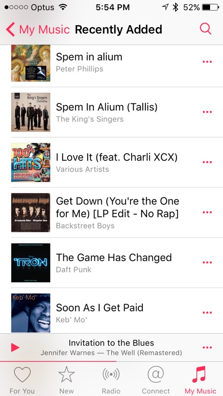

For example I enjoyed playing this lot today ...
