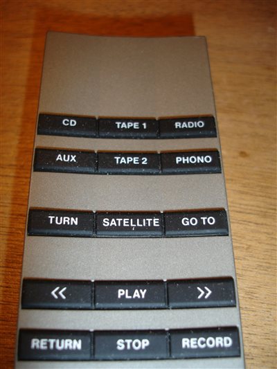

Bizarrely, you may be able to achieve what you want (single button press) with an older remote - like this one:
And I do not think that you should have to press 'LINK' first in the living room, 'AUX' alone should suffice - what are your option settings?
And what do you have connected to the AUX input in the main room?
What is this? The super rare Beolink terminal XXX? Never seen that before!
Guy, I have been looking for an Audio Terminal for quite some time. If this is a picture of yours and if you are willing to sell, I am interested.
Thanks :-)
Yes it is mine, bought a couple of years ago on UK eBay.  Didn't realise it was so rare, but sorry not for sale!  If I change my mind I will be in touch!
BTW it might be helpful to know more about the setup, products, configuration....
Stefan
it is a Audio Terminal
together with the Video Terminal and the AV Terminal (an Audio and Video version)  they were the predecessors of the Beolink 1000.
