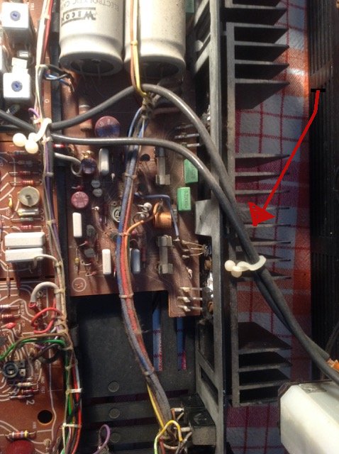

This is the heat sink that gets very hot....

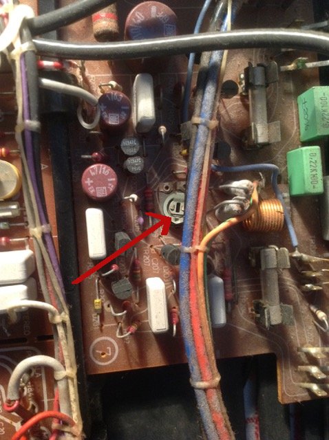

Is this the trim pot that needs to be replaced?

Did you measure the idle current?

I don't know how to do that, I'm afraid. Where do I measure it and what should it be?
/riis

All described better in the servicemanual than I can do here.
If the trimmer is to be replaced, you will have to adjust the new anyways - but check it before touching anything
and see, if the diagnose is correct.
Martin

riis replied on Sat, Mar 5 2016 5:49 PM
The diagnose was correct. I have measured the idle current and it was very unstable. After replacing and adjusting the trim pot the Beomaster works great again not getting the least warm. All that is left is to replace a few lamps.
Thans Ricardo and Martin for your help.
