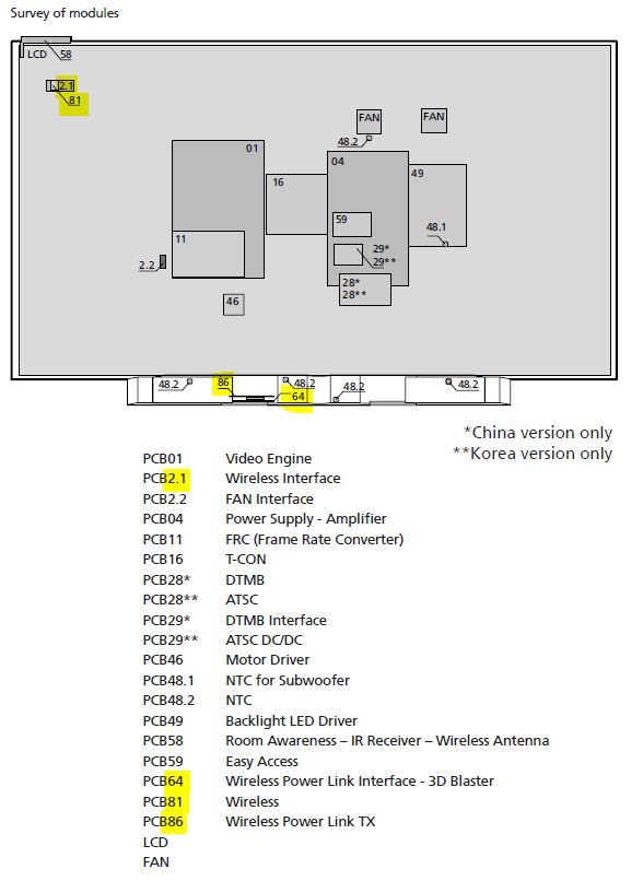

Excellent questions regarding the Moment and TV speakers. When I fire up the Moment from the BeoRome 1, I find it quite usefull that the screens comes on to show me what it will play - however, it stays black when changing songs on the Moment tablet. The Moment tablet fades in/out whenever a new track comes on.
The one thing I am not happy with is the fact that I only use the BL18's connected to the TV for music, not the internalt speakers of the Avant, and yet the speakers lower and extend every time I activate the Moment. I prefer the clean look of the TV with the speakers hidden when I listen to music. Hope they can sort this out in a future s/w update.

I guess that could be the case, but even more annoying as I had to wire all my WiSA speakers due to poor stability - and now have the WiSA module disabled. Dropping wireless transmission also got rid of a slight delay between the left and right channel when listening to music via the Moment.

Looks like you are correct, MM - there are a total of 4 wireless modules in the Avant, two of them just below the Room Awareness sensor (wifi?) and two in the speaker cabinet (Wireless Powerlink Interface).
The delay may have been present on normal TV viewing (listening) as well, but the center channel typically dominates the sound stage and may camouflage any flaws. The delay was not a big problem for the mrs in the house, but it actually gave me a type of headache that was unbearable when listening to the Moment. To me, it was very noticeable when listening to a dialogue on radio - sounded like an old equalizer from the 80's with the echo-function activated.

Seems that this is something, that Avant users have to live with...unless the choose to make differenciated settings with or without WPL enabled.
Hopefully they will think of this issue in future tv's and place the modules differently :-)

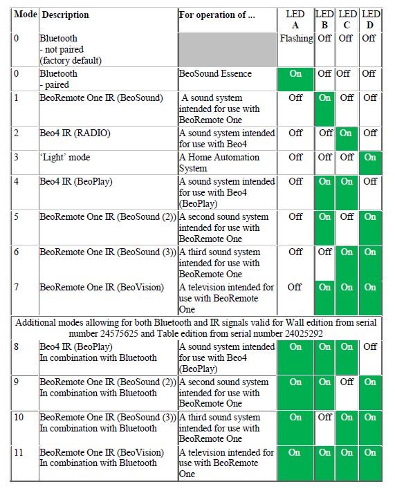

Sorry, just going back to this - the Essence Remote would have to be set to BeoRemote1 IR mode and can't continue to talk directly to the Moment via Bluetooth?? Seems odd.

Yes, you should set the Essence Remote to the correct BeoRemote 1 IR mode (LED A off, LED B/C/D on).
However, I must admit that - for music - both the Essence Remote and the BeoRemote 1 are not used that much. Either I end up using the panel of the Moment or the smartphone. There is one too many users in our house, and just pressing the button for music on either the Essence Remote or the BeoRemote 1 will usually give me some radio station or a Dezzer/Spotify playlist I have never heard of :) This goes for the pattern play on the Moment, too, I'm afraid - a feature along the lines of MOTS when it comes to actually being used IMHO.

Ha - interesting real-world usage feedback!
So using the panel on the Moment will activate TV and the speakers attached to the TV, but activating the moment with a Bluetooth connected Essence remote won't - weird don't you think?!

Indeed - and they only recommend the Bluetooth setting for Essence, all other configurations should use IR. And even those are confusing: if you do not have a BV11/Avant, you should use mode 1 (LED B on, LED A/C/D off)... this may change when they launch the BeoRemote 1 Bluetooth edition.

So if you have an Avant in the same room as the Moment and an Essence Remote on the wall in IR mode - will it be possible to set the remote to an IR mode that just talks to one of those devices?

Sure, there are quite a few options you can go for - I'll try to upload all of them below:

Magic thank you! Wonder what the combo (Bluetooth & ir) modes are for?!

In my understanding it sends the 'usual' bluetooth commands for e.g. the Essence and at the same time an ir-command for an ir-compatible B&O (video/audio) device....
....but the question still remains: which ir-command???
Which command would the mode 8 send to an older audiomaster?
