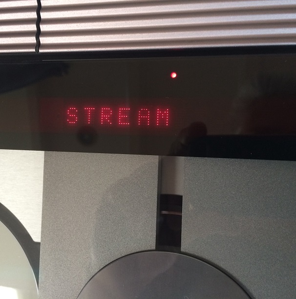

Although not full HD it has this nice warm tint, compared to the newer revs.
And Personally,- I am a sucker for the RED display,- and of course the options the cinema output provides!
Thanks BEOVOX141,
you're right, the red display on the BV7 looks very nice combined with a BS9000 next to it.

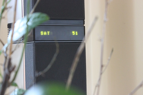

BEOVOX141: And Personally,- I am a sucker for the RED display,- and of course the options the cinema output provides!
I do like the red display either. But am not really convinced if I changed my mk3 Penta displays with the same red matrix from the BS9000, that it will look better. The green colour of these are "softer" to watch
@Beobuddy
I couldn't agree more
