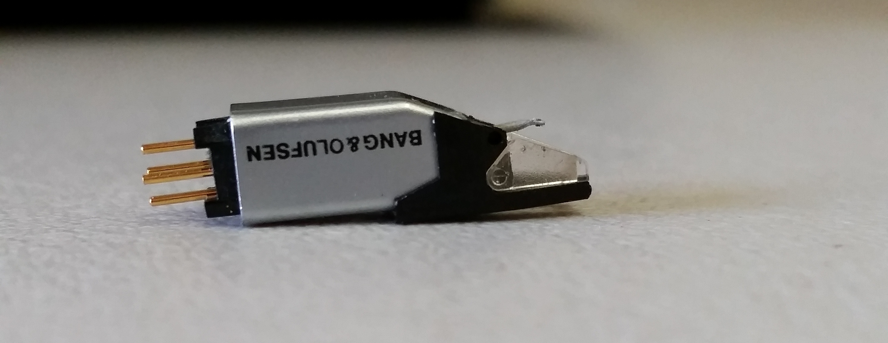

009 jpg.732985Well, got a TX-2 and it would appear the stylus is toast. How do I remove it to check out closer?  Will enclose a pic showing what would appear a bunch of scratches/marks right under the stylus in the plinth.  Looks like it got slammed down a number of times and smooshed the stylus :(
Thoughts?

brought this to a nice audio place here in town and he could not get the cart off the arm.  he held the arm and pulled on the cart and it would not budge.  thoughts?

That's the correct way to do it.  Try twisting the cart while pulling it out.

Did it myself and don't know why the shop couldn't do it.  Oh well.  To me the stylus looks like toast :(

And yes, the stylus on the other cartridge is bad. If the coils inside the cartridge are still good, the cartridge can be retip'ed.
