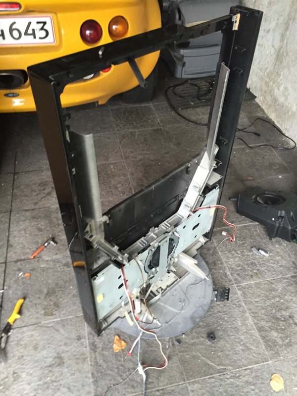

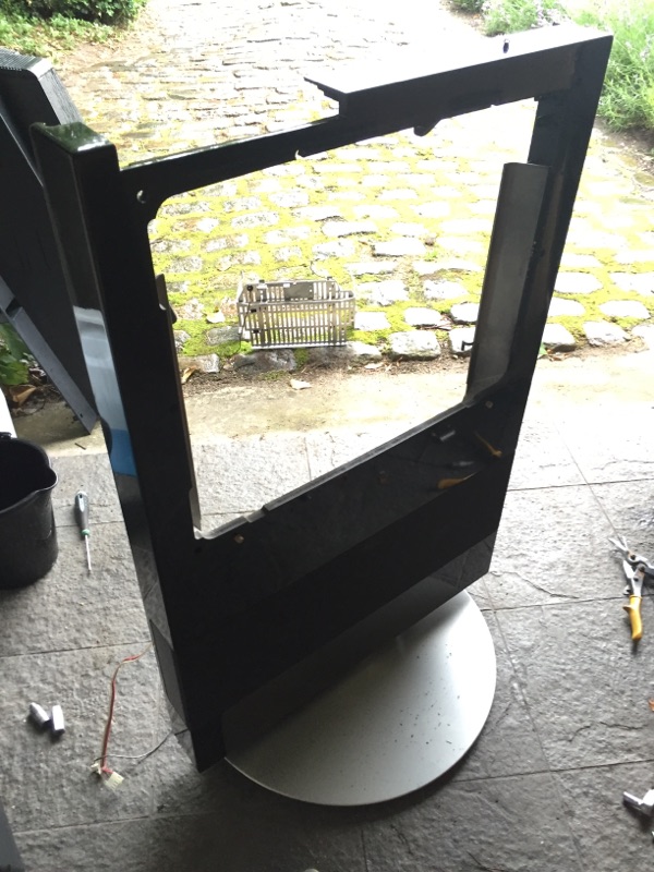

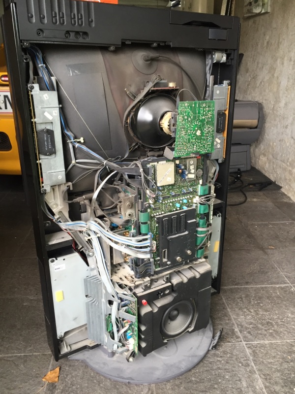

Which made me think,- Why not take the base from an old Avant. The center of gravity should be about the same, and the MDF chassis is not only rock solid, but also very easy to modify! The motor assembly is no more than 2 inches high, and would look great as a tabel stand!
I have made several stands from recyled Beovison parts, AV9000 , BV7-32 and the Avant
If you need parts let me know :-)

BEOVOX141:The BV4-50 comes in at a whopping 50kg! Which made me think,- Why not take the base from an old Avant. The center of gravity should be about the same, and the MDF chassis is not only rock solid, but also very easy to modify! The motor assembly is no more than 2 inches high, and would look great as a tabel stand! I have made several stands from recyled Beovison parts, AV9000 , BV7-32 and the Avant If you need parts let me know :-)

Very nice, indeed - applause again.
P.S. You 'could' have made a nice center speaker tor that tv with the AV5 speakers unit, couldn't you?
