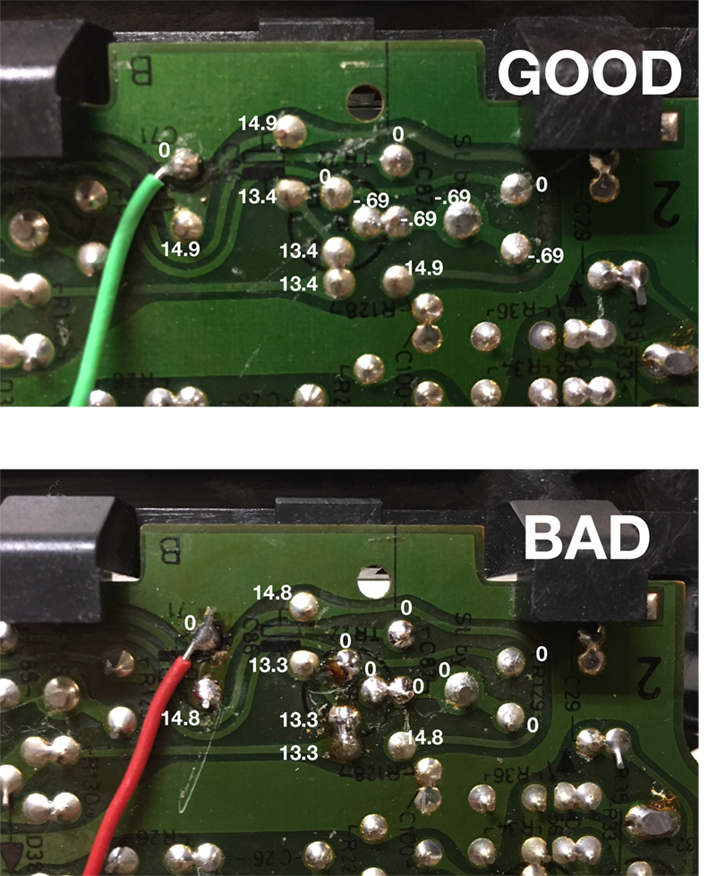

More digging. Keep in mind I'm at least the 3rd person in here, and I suspect I may be 4th. So I'm working with the previous fixes, as well as working from the one IC volume board schematic instead of the 3 IC schematic, so that's making things tricky.
I think my issue is on the volume board, anybody chime in if this makes sense.
The checks in the images are the spots that I believe I'm pulling correct voltages based off my working comparison 2400.
The Xs are where I'm getting no signal, but I believe I should be.
The little power symbol in the upper image is where if I try to pull a measurement of either the end of R58, or the base of TR21, it triggers the system to power on.
The red line in the second image is if I run a jumper between those two pins, pulling a measurement of either of those two spots no longer triggers it on, but it gives what I believe is the correct voltage reading.
My inclination is that L1 is bad. Does that seem to make sense?

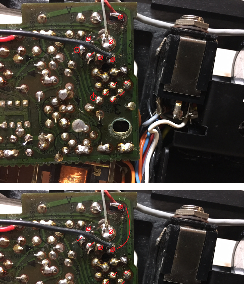

Fixed.
I unsoldered L1 last night, and ran an ohm meter across the leads. It showed similar resistance to the working version, and the leads were all connected as they should be, so my guess was L1 was still intact.
I took another look at the board, and went back to questioning why running a jumper was stopping it from triggering the system on.
It looked like one of the connections was bypassed. I am unsure if it was from the previous owner trying to make the LEDs in the tonecontrol board function, or if they were bypassing a burnt section of board. I think I assumed it was because of the missing solder pad, but since it worked before I corrected the bulbs, I think it may have been related to the LED modification.
At any rate, I reran all the connections correctly, with a few extra jumper wires given the condition of this board, and now L1 is giving the appropriate signal back to the sensitouch transistors.
I put the front panel back on, which I'm pretty good at now, and everything triggered as expected.

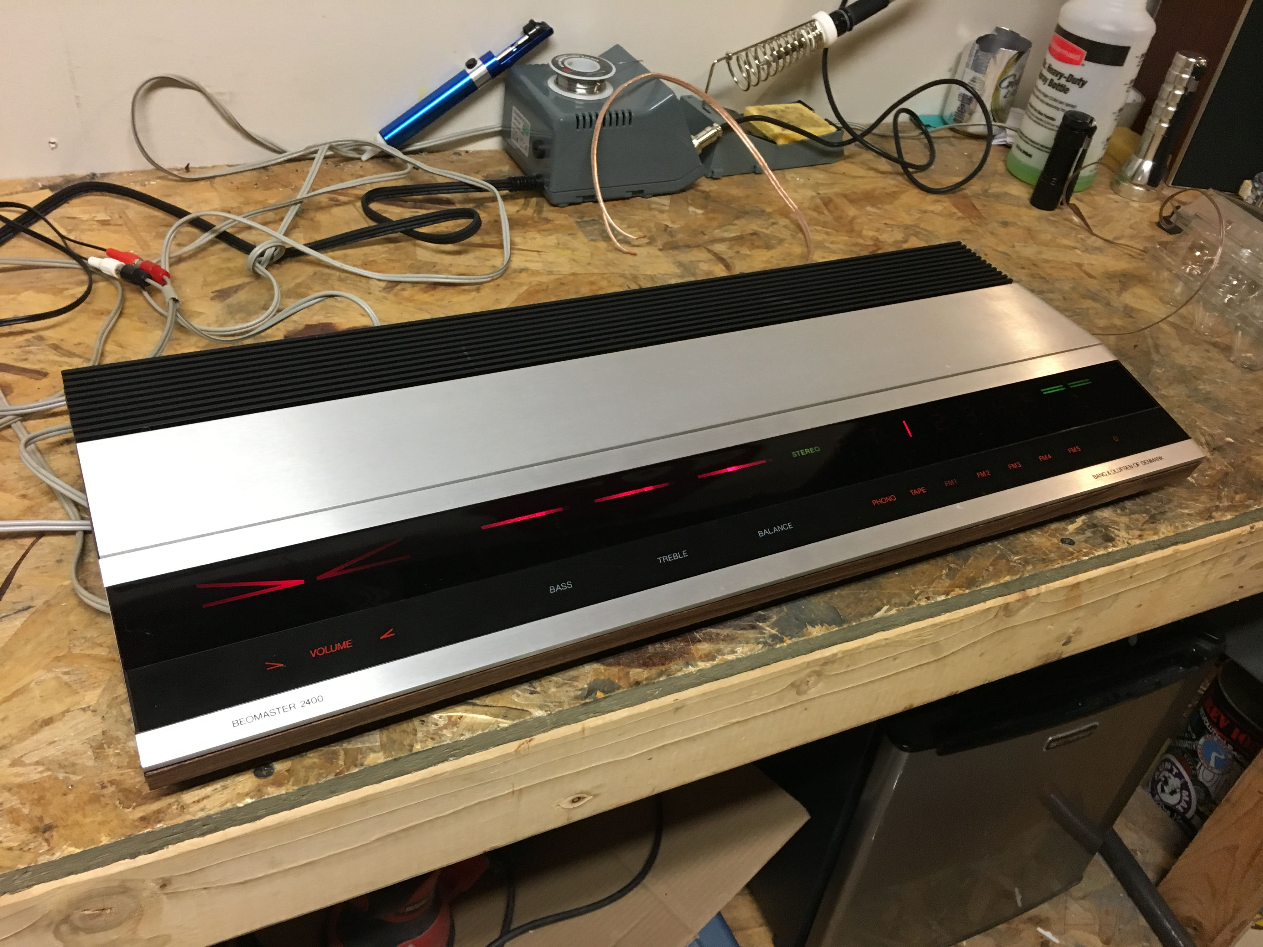

Here it is, just in time for a Led Zeppelin weekend.
For my first non-speaker electronics project, I sure picked a doozy to learn on. Trial by fire I say.
Beautiful machine though, couldn't pass it up.
