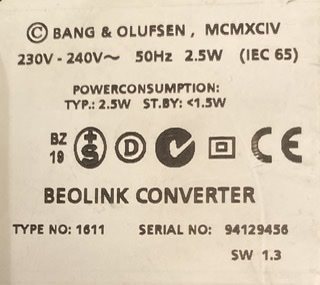

I have SW 1.3

Hi Steve
Is type 1611 the same as 1614 ?
Steve at Sounds Heavenly
The cable workshop, Leics, UK
Posts 2,165
Hi,
No, each type of converter is different.  Please look for a type 1611 converter that carries the full version number 1161166 on the sticker, this is the only one to use as it is the only version that can act as an ML driver.
Kind regards, Steve.

gerard replied on Fri, Dec 25 2020 5:30 PM
Hi,
I can't find the full version number on my Type 1611 converter , could you please tell me if mine is the correct one to get an AUX signal into my system, BV10 with BS/BM5, or where can I find the full version number?

mauribits replied on Thu, Jan 13 2022 1:35 PM
hey steve,
i have all, the correct converter, all linked, sound is there, however the system will not go on when i press TV on the remote, what am i doing wrong?

Hi,
It may be the option setting on the Beomaster 5, or the converter may not be the later version that can act as an ML driver for this setup.  The later versions of the Beolink Converter should show the full type number 1161166 on the sticker.
