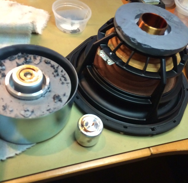

I once got his. A broken magnet inside.
Ordering a new woofer wasn't in it's budget, so fixed this one. But nevertheless, in this state they don't do much..
Forgot to mention, broke after shipment in wrong package.
ugly injury ... very sloppy sender

Look pretty bad to be honest. The problem might also be that the magnet is simply to heavy: when the speaker makes a drop means that the heavy gains to much energy so that it will crack off the rest of the speaker. In other words: the weight is not considered while designing the speaker when falling. It might be a "design flaw"sort off ....
