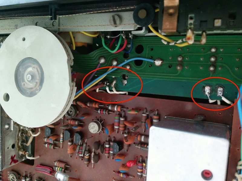

OK, after another inspection I found the bad connection of the wires coming from the tuner board, after resoldering them, I have now sound (the FM hum) coming from the speakers. Tuning scale doesn't help and it cannot catch any station, just hum, so I continue to inspect the item.

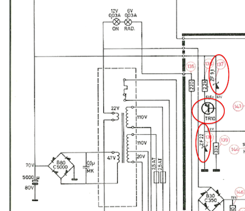

As I said earlier, the tuner didn't work at all, I just heard static hum from the speakers and couldn't catch any station, so I assumed something was wrong with the tuning voltage and started checking the voltages with my multimeter starting from the entrance to the tuner PCB. Luckily, the problem was diagnosed very fast. As I read here on the forum, the first thing to check here was the TR10 transistor, which was blown, I have changed it with the equivalent modern one.
This had no impact, since the voltages were very high on the emitter, base and collector of TR10, I don't remember exactly, but something around 140V. So, I assumed something was wrong with the Zener diodes close to it. The diode 137 (which is a ZF 9,1V, 1W, BZX55C9V1 Zener diode) was checked with my meter and was defective, so I exchanged it with the equivalent modern one 1N5239.
The problem remained and that's when I found out the completely blown 138 diode (which is a ZF22V Zener diode):
I have changed this one with the equivalent modern one 1N4748A, 22V, 1W diode.
I turned on the BM4000 and...now I can listen to any FM station I want... finally :)

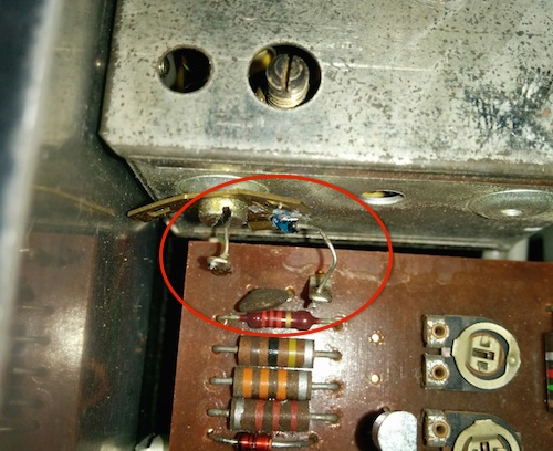

P.S. does anyone know why the ZF22 diode was screwed (or covered?) to the ground of the metal case? Now everything is working properly, I doubt I should do the same with the new diode...
Dillen
Copenhagen / Denmark
Posts 13,191
Dillen replied on Thu, Mar 30 2017 11:15 AM
andreis2009:
Yes.
The diode maintains a steady tuning voltage.
Any drift in voltage will cause a drift in tuned frequency and you would have to move the tuning slightly every 2 minutes or so - quite annoying.
The diodes properties changes as it (and the Beomaster as a whole) heats up so to avoid voltage drift it uses the frontend metal housing as a cooling fin.
It needs to have a good thermal contact.
Mount with thermal paste.
