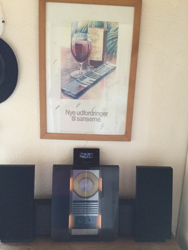

Shaun. replied on Tue, Mar 21 2017 1:27 PM
I got this dab and Bluetooth radio.
It works realy good.🌹🤗
http://shop.oneremote.dk/catalog/product_info.php?products_id=3800
