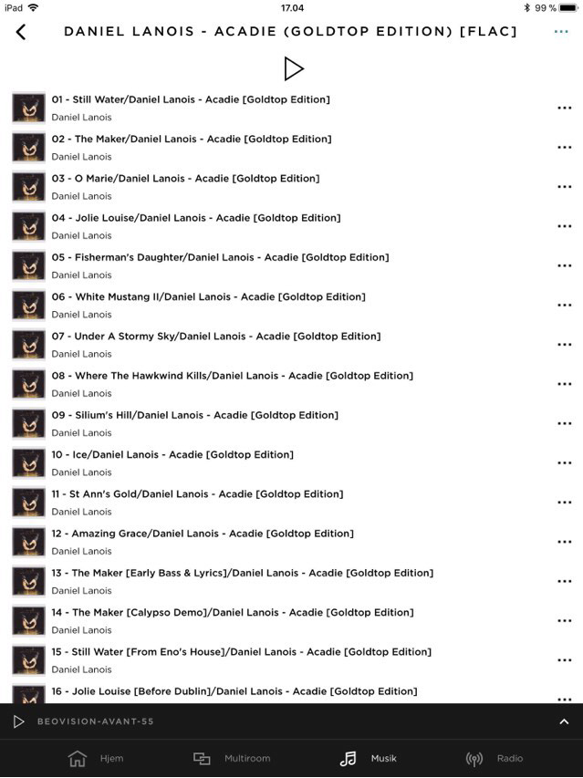

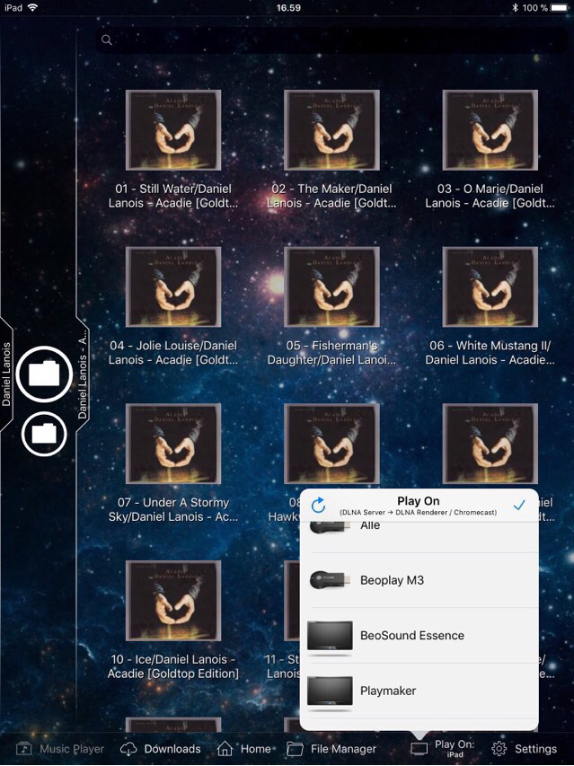

It is something like this.....if only the Avant etc would appear as a DLNA renderer there (as earlier).
Millemissen
Flensborg, Denmark
Posts 14,680
Or this - if only the BV Avant etc would allow for playback.

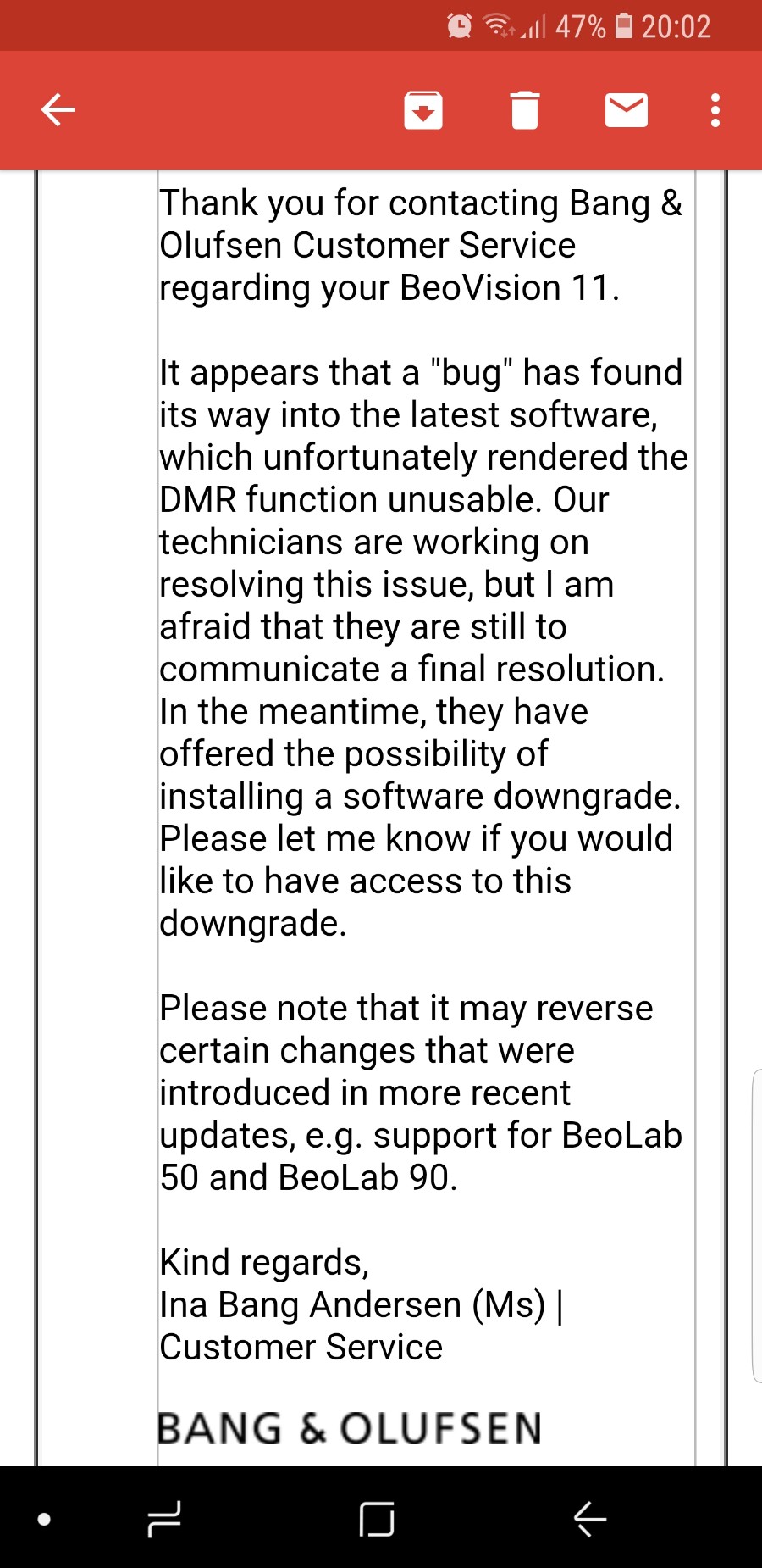

Yes, the update issued ‘the problem’.
I have just bin informed, that there (probably) will not be made any new sw version.
However, it will be possible to downgrate the current version to an earlier, where the DRM function in intact.
As far as I currently know, it can be done via a technician.
How and at which costs, I don’t know right now - will report back.
Anyone interested could ask his dealer and - please - report back here.

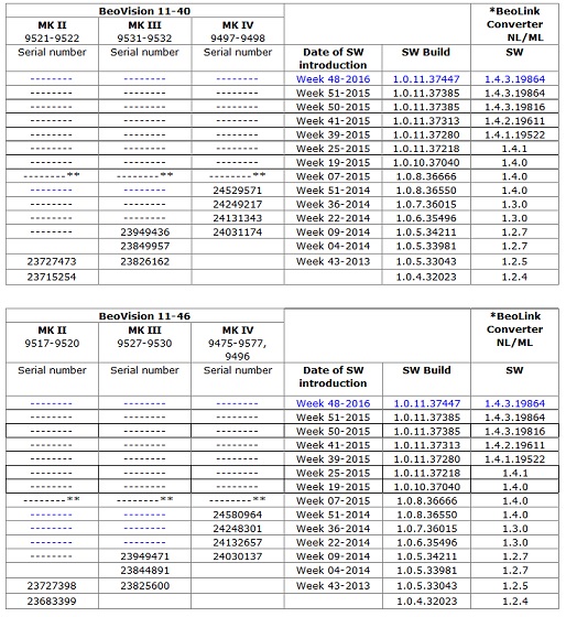

Anyone who has the BSys4-platform software version history - and could post it.
Seems hard to find these days ;-(
Keith Saunders
Top 25 Contributor
Hampshire, United Kingdom
Posts 5,495
Millemissen:
I think this is what you are looking for -- BeoSystem 4 / BeoVision 11
Regards Keith....

I have now received an answer from Bang & Olufsen Support.
They acknowledge that they are aware of the problem, and they are trying to find a solution. Currently the only work-around is to downgrade the software. My local dealer should be able to help. They will keep me informed of any news regarding the problem/solution.

Keith Saunders:
Millemissen:
Thanks for that chart, Keith.
A good overview!
However, I was thinking more about the changes from the previous to the current  sw version of a e.g. BV11.
What was gained (we know what was lost!) - what do we loose (if anything inportant), if we downgrade to the previous sw?
If I remember well, the support for configuring/using BL50/90 (and presets for these) in the setup was part of the newest sw - something, that probably most of us can live without....

I've attached the answer I have received from Beocare

BenSA replied on Fri, May 18 2018 7:13 AM
So I sent the message I received from Beocare to B&O South Africa, they have sent me the software and instructions on how to download it onto the Beovision. So I will give it a try hopefully this weekend and see if it solves the problem. I am sure it will.

I did the downgrade this morning (on my V1-32).
Will report back with more details and pics later on during the weekend.
But you must be aware, that you will loose the NetRadio function from the current version!!!
You also won’t be able to use and have direct access to Deezer.
As expected the DRM-function works again - from 3rd party apps (8Player etc), but not from within the Bang & Olufsen app.
Beware - if you come across the needed sw, that you are doing this downgrade on your own responsibility.
In my case it ran smooth and without problems - same goes for the following upgrade to the current version, which I did less than half an hour after the downgrade ;-)
I’ll stick to the newest version - in the end Netradio is more important to me than the DRM-function.
