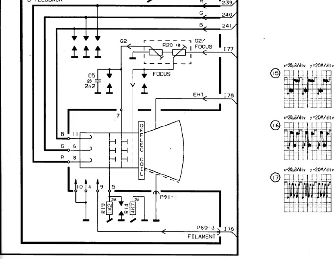

Below is a diagram of the MX7000 tube connections
Regards Keith....
