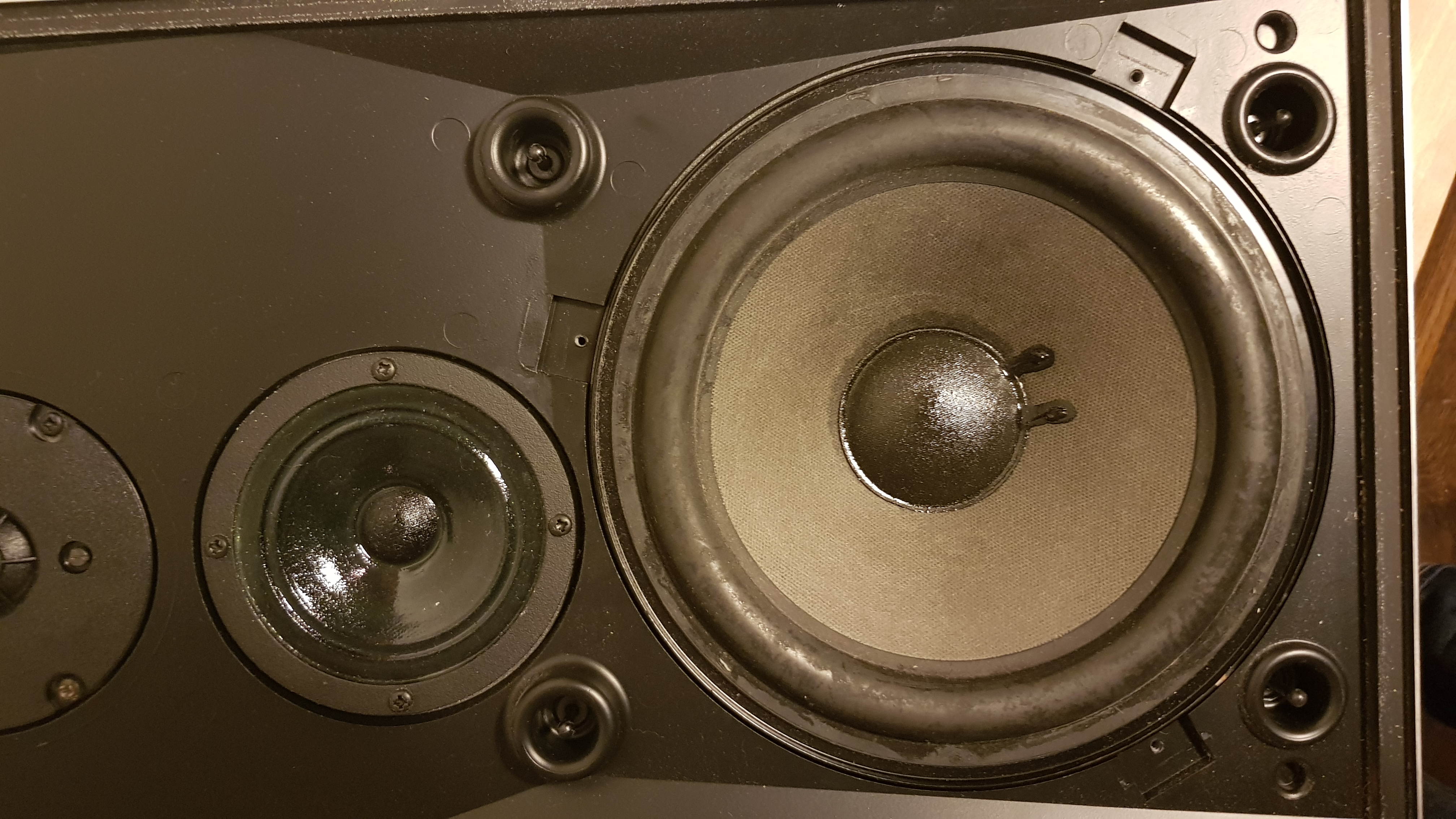

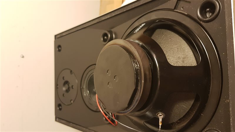

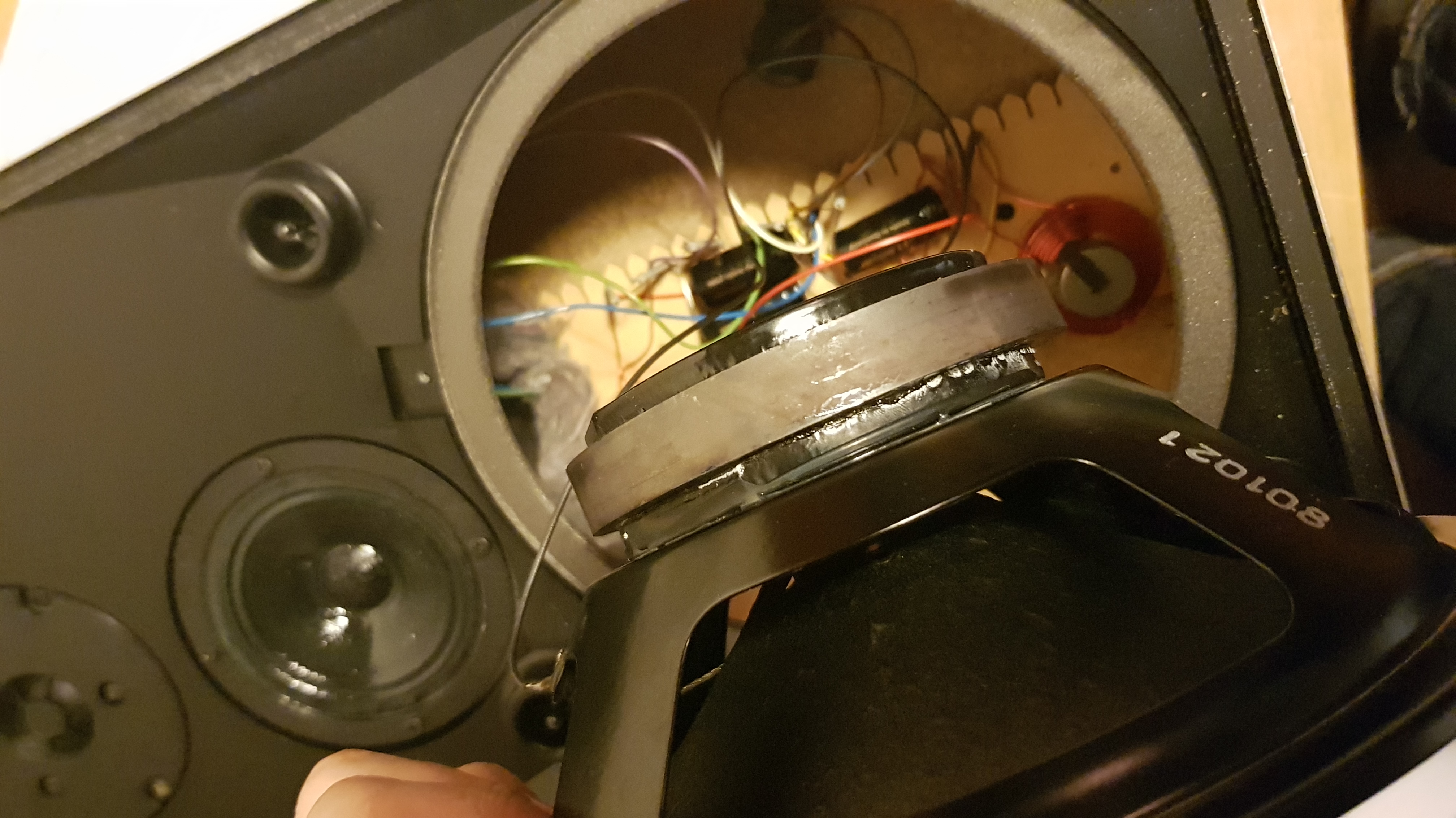

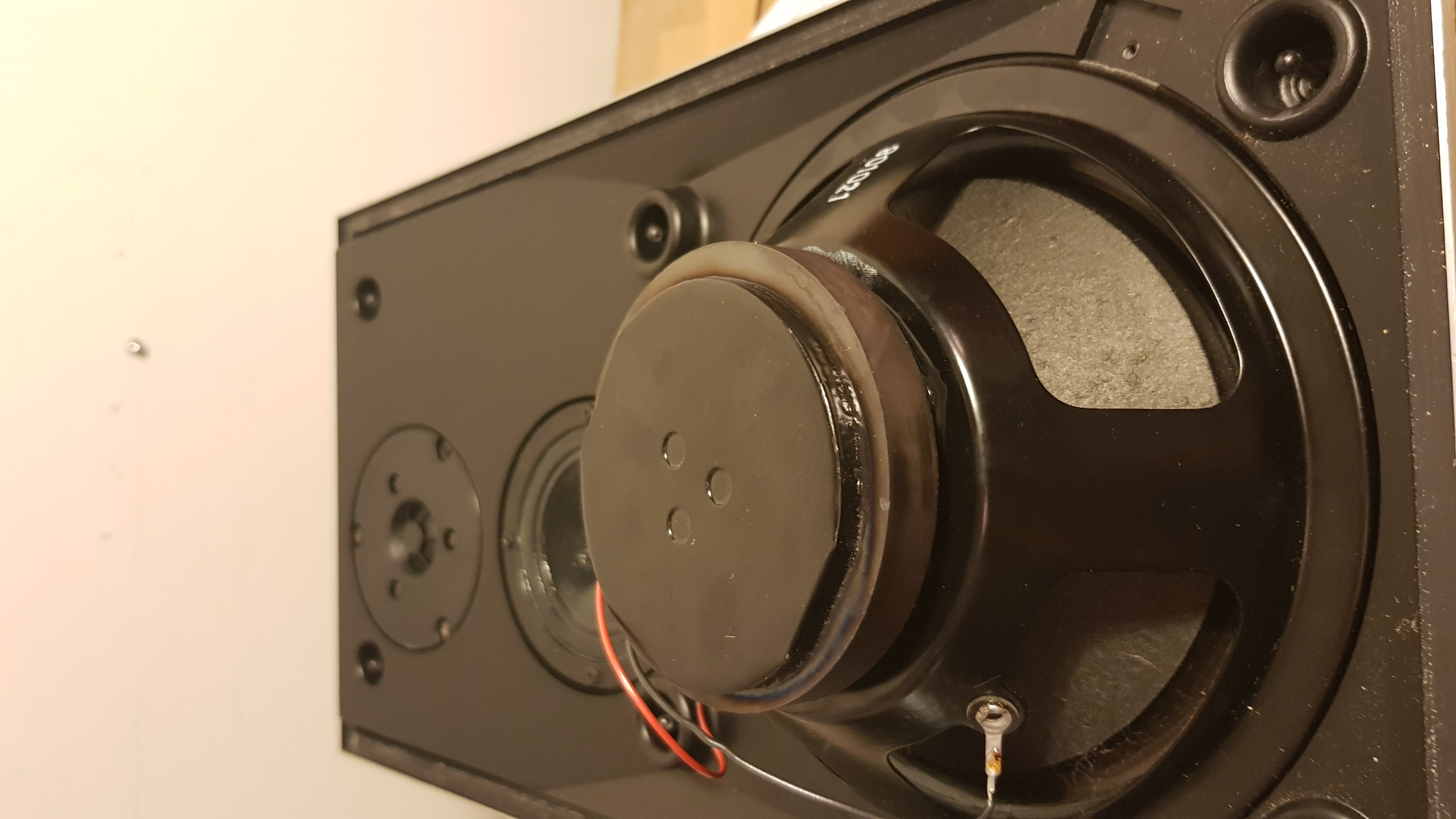

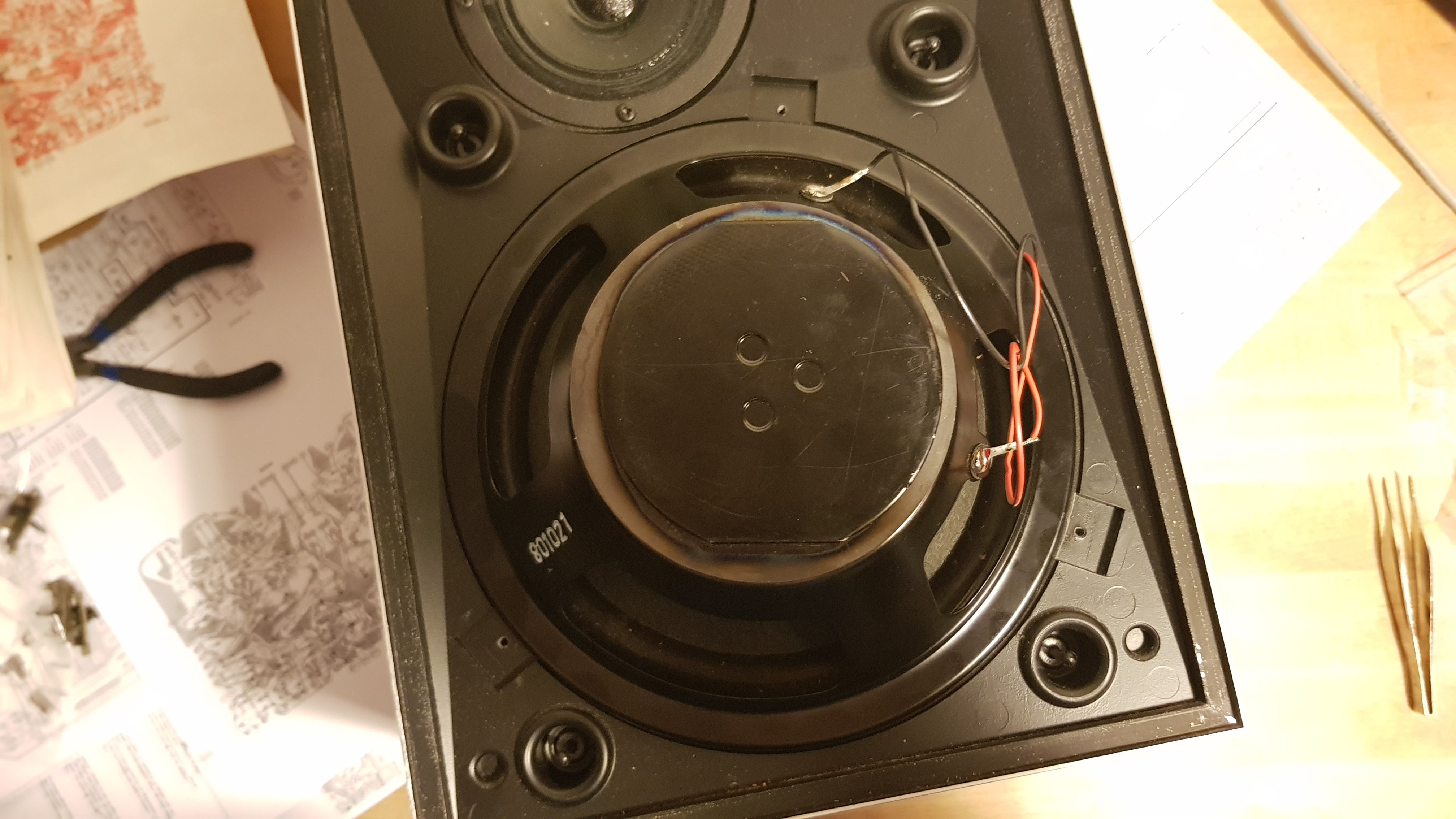

Thanks Craig. I'll see if I can get a few pics when I take off the dust cap to inspect the insides. Externally it looks ok, don't know if they are helpful but here are a few I took just now:
Craig
Yarm, United Kingdom
Posts 2,040
Silver Member
Craig replied on Thu, Oct 12 2017 6:40 PM
I agree the pictures are not very informative, the speaker looks in good condition. However if the coil is scraping on the sides of the frame or the magnet core it will have to be centralised...this can be done and its not all that difficult....bit tricky and requires some patience. The diaphragm should be holding the cone and the coil centrally in the frame....if there is no obvious damage to the diaphragm and cone them your going to have to remove the magnet and reset it, afte rall you have nothing to loose by making the attempt.....check out my thread on this subject before you start, and good luck ;¬)
