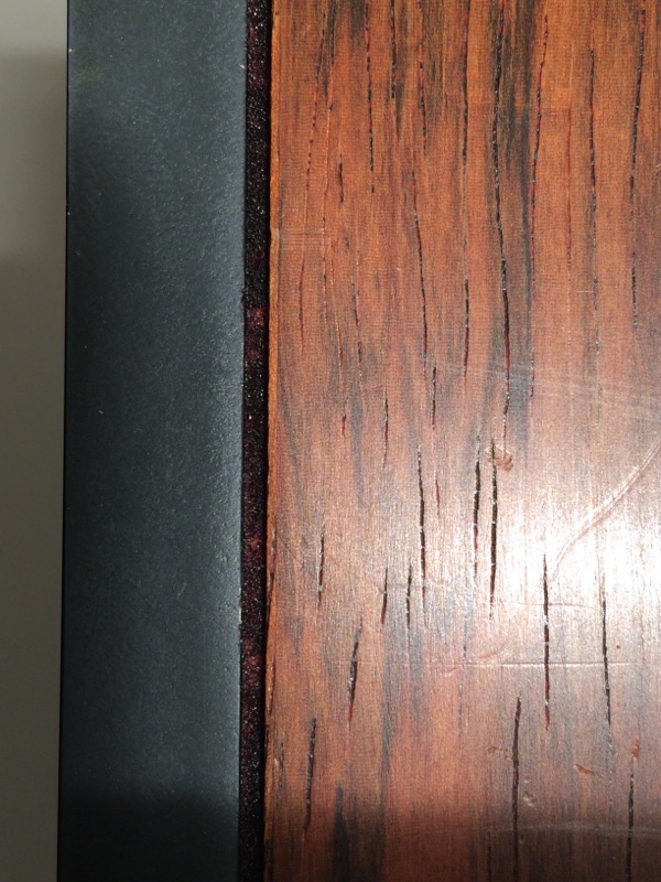

Søren Mexico
Mexico City
Posts 6,411
Rosewood sanded, right side not sanded yet
Finished with linseed oil, beautiful grain

Søren Mexico
Mexico City
Posts 6,411
Pry off the fronts with a screwdriver they are nailed to the cabinet (maybe some models are glued).

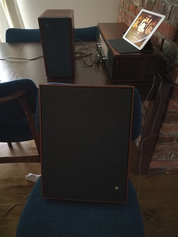

peternovy
Posts 53
peternovy replied on Wed, Nov 15 2017 8:17 PM
Great pics! I'll try to get the grills off during the weekend. Here is a photo of mine, they are in pretty good condition, except a couple of slightly chipped corners. But they do have the little gold B&O logos! And they sound great!

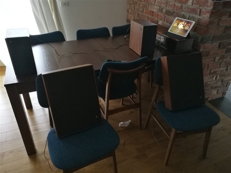

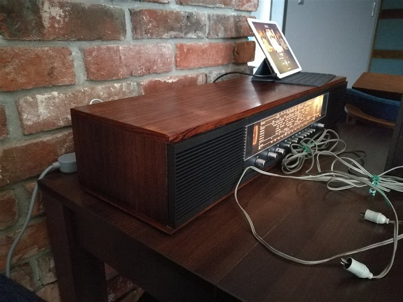

peternovy
Posts 53
peternovy replied on Sun, Nov 26 2017 11:49 AM
OK, so here is the finished repair, the cabinet and the corner sanded and oiled. Some signs of damage is still a bit visible, but only after looking at it closely. Given the situation I couldn't really hope for more. Thanks for all the advice!
I am now enjoying some good contemporary jazz played through the BM900K and trying out the different speakers - I have Type B and recently purchased Beovox 1600. I've seen the 1600 praised here on Beoworld before, but I must admit they do sound amazing! And they have not had any work done to them! Some pictures below.
