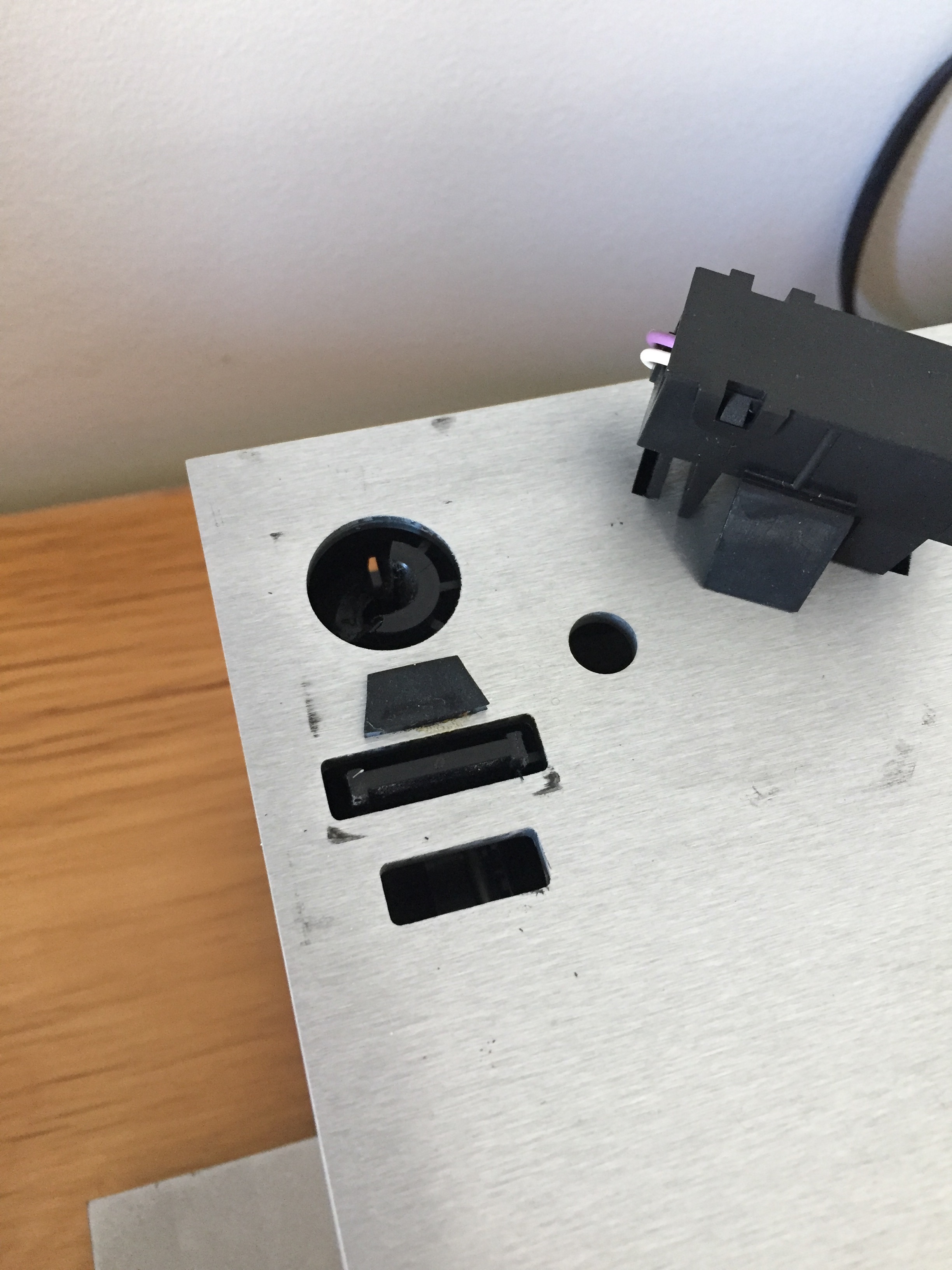

Hello - it's the plastic tubular pieces in the back corners of the deck, in which the brass screws sit in, which have broken - without taking the body of the deck apart, I'm imagining these are part of something bigger Sad
see photo...
Dillen
Copenhagen / Denmark
Posts 13,191
Dillen replied on Sun, Nov 5 2017 12:32 PM
I just had a deck with the same problem on the bench here,.
Strong 2-comp. epoxy glue is what you need. I like to use Araldite Standard, the white/blue slow setting type.
If you cannot glue the brass insert back into the plastic chassis and add some support, you can simply glue the
metal bracket to the deck surface.
Martin
joeyboygolf
Top 25 Contributor
Ely, Cambridgeshire, UK
Posts 4,188
This exactly the area that I am attempting to describe in my post.
It is impossible to expose any more of the broken part without completely wrecking the deck.
One suggestion that worked for me on a number of occasions is to buy a cosmetically challenged and cheap Beogram 5005 or similar brushed aluminium deck and build your 6500 parts into it.
NB All type 59xx decks are the same under the skin (some early examples do not have fixing points for the RIAA preamplifier) .
Regards Graham
jgharrison86
Posts 12
Hi Martin - thanks for the tip. I will look into carefully re-affixing the broken plastic parts with araldite.
Graham - this could also be a good avenue, I'll keep my eyes peeled for one...
