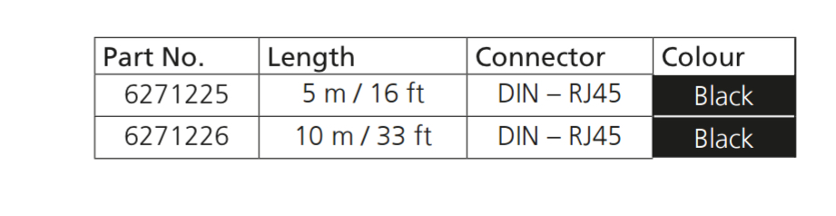

If you order the cable from a B&O dealer, this is it
It is the socalled fully wired PL cable.
As written above, you can also get it from the site sponsor Steve SoundsHeavenly.
