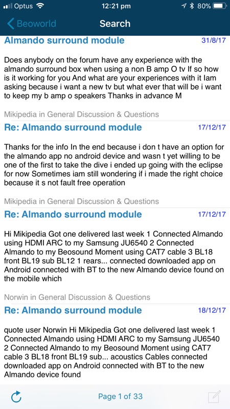

elephant replied on Thu, Dec 28 2017 1:18 AM
Mikipedia:
Hmm, that’s a hard(er) one. Does the tv have a surround decoder? If yes, go with the almando surround box and then it’s easy. Other than that iam not that well versed with other recievers that could work.
The cnet specs say “surround sound....yes” but not the level (5.1, 7.1, ...)
There is a toslink optical digital output ... but I can’t make sense of the specifications of RCA, RCAx2, RCAx3 !
There are many threads mentioning what Mikipedia has recommended. When I find a reference I’ll post it for you.

elephant replied on Thu, Dec 28 2017 1:23 AM
Can’t copy and paste the text !
Try Search function for this almando thread ... started by Miki Big Smile
