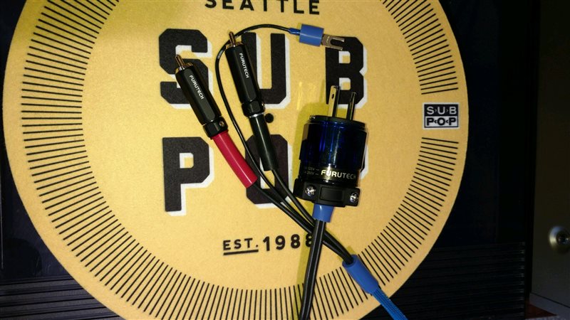

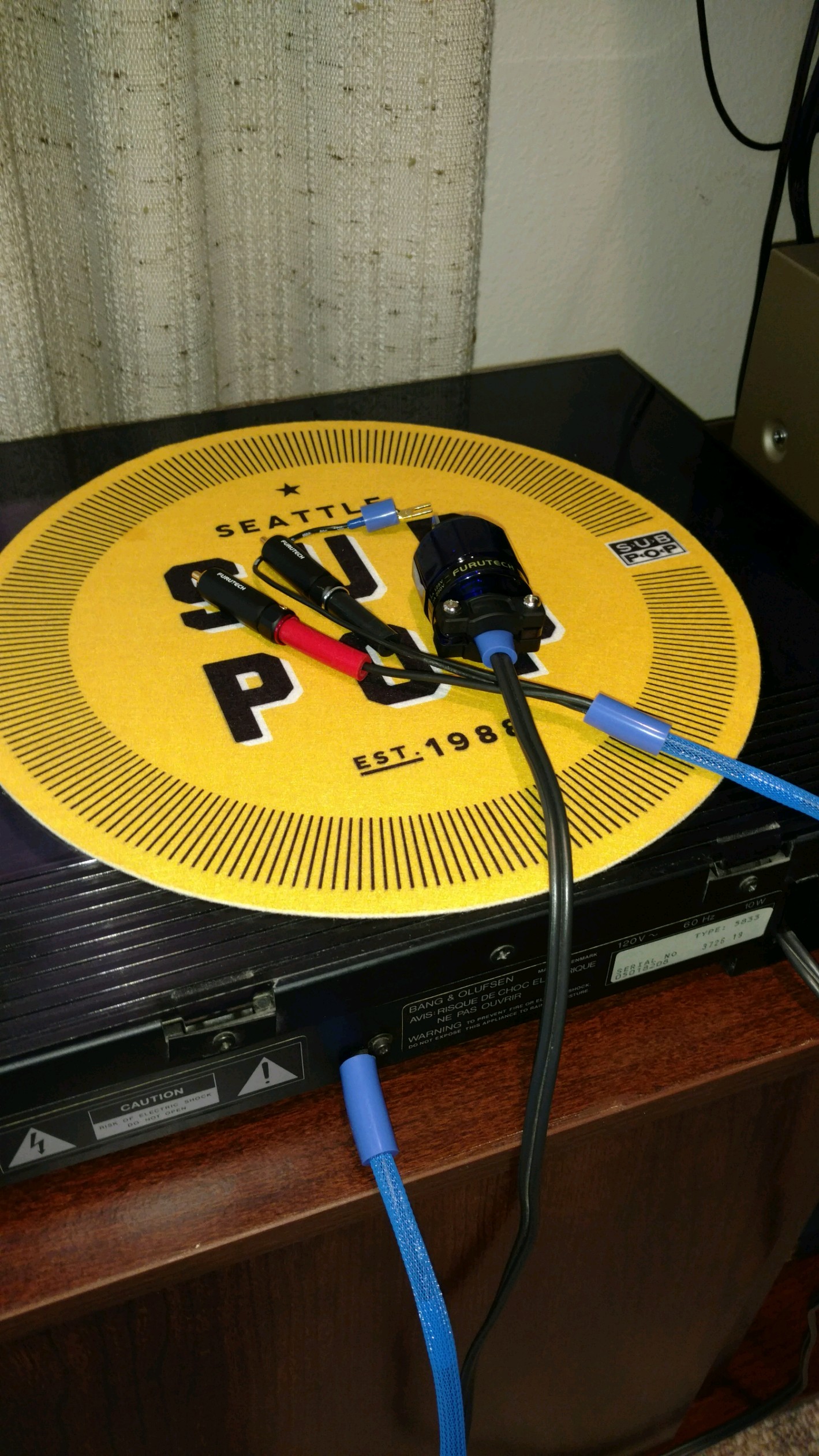

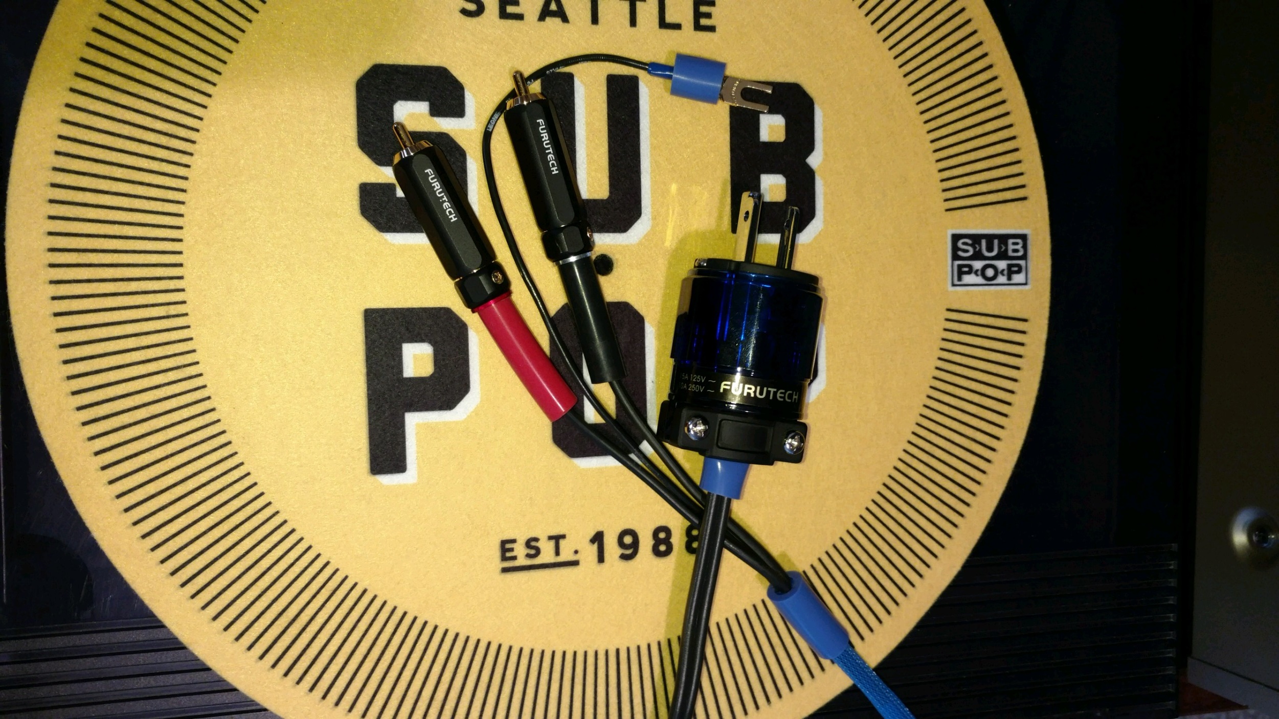

After removing the top plate, I quickly realized there is absolutely no space to add RCA females. So I ordered some Furutech connectors for everything. New RCA Males, Ground Spade and AC Plug. Aside from the one bad RCA jack, my power cord had damage from a previous rabbit roommate. Bunnies love to chew on cords. I lost 18" off the power cord. I sleeved the signal and ground cables to provide better cable management. The ends of the sleeving are kept nicely in place by some simple silicone vacuum hose. The whole thing turned out great and no more buzzing from the jacks. The Furutech connectors I got at a great price off eBay. I just had to wait 3 weeks. These connectors are over the top superfluous and the whole project could have costed much less. But I'm happy with the end result.
