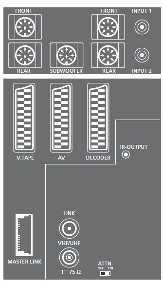

Hi Fritz,i've been trying to send you a picture of the back of my tv but i don't know/can't seem to upload it to you(told you i was rubbish with tech) there are however 5 small pin sockets at the top and to the right of them there are 2 single hole sockets and then below all of those(the 5 small pin sockets and 2 single hole sockets)are 3 scart sockets...
Stoobietoo
Exeter, Devon, UK
Posts 692
Does it look like this? (Taken from my BV5 user manual.
Stoobie
Westwood69
Posts 6
Hi,yes that is what the back of my tv looks like..
Stoobietoo
Exeter, Devon, UK
Posts 692
Initially I had an Apple TV on my adapter plugged into the AV scart socket and went into the TV settings to ensure the AV scart was enabled. I could the use the apple PUC to control the ATV. It worked brilliantly for me. I now use the same adapter in my Beocenter 1 TV (scart only) and it works perfectly.
As fritz says, you'll need to replace your adapter as it is not the correct one. Hopefully they will refund you or swap for the correct version.
Stoobie

Hi Again Westwood
No picture needed, message well understood
You have a BV 5 MK one.
You need a adapter HDMI input to SCART (RGB output) this will give a perfect picture and sound.
Good Luck
Brgds Fritz
