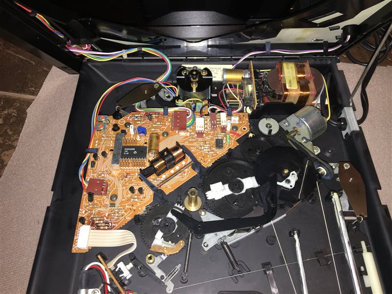

This is a common problem with shipping these units. I've tried to do everything I can to minimize shipping damage. Luckily this is easily fixable. 1st remove the platter, spindle, and belt. 2nd, turn table over and remove the two screws on the underside. 3rd, open up the table (move the tone arm carrier to the inmost part of the deck, and open the "hood". You'll see a long metal spring that goes from the front of the table to a white tube that runs along the tone arm. It's just jarred loose. I'll look up some pictures, and send them to you. It's a 3 minute fix.
I guess calling it a spring isn't technically correct... It's just a small metal rod with a two prong fork like end.
(I add this picture of my Beogram 9000 to help show what I think could be wrong with it)

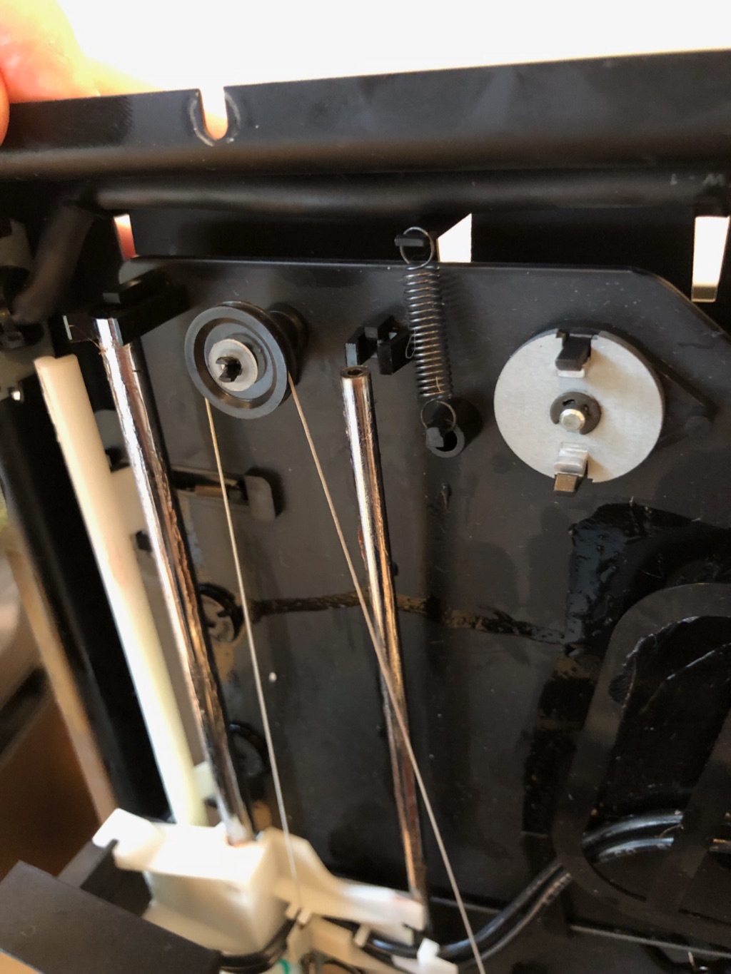

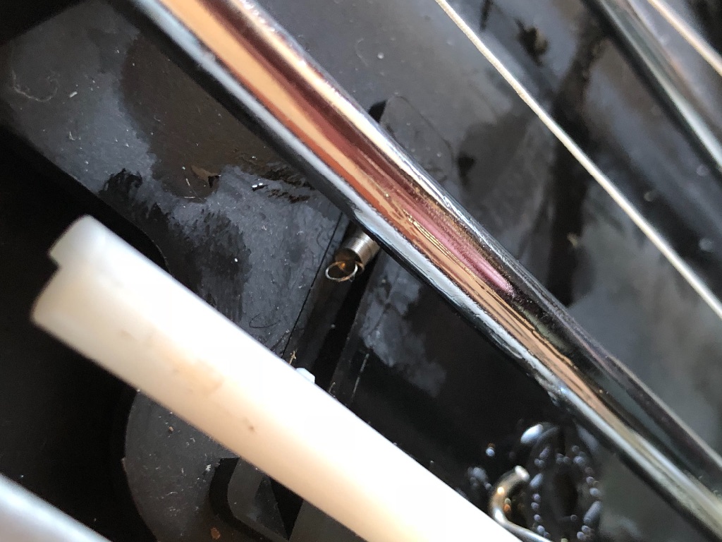

Thank you for the detailed walkthrough. Unfortunately this did not solve the problem. There are other issues, the bracket is broken off and the spring has come loose and cannot be attached so the needle still does not drop. I have attached pictures.
I respond with:
I can't see any photos. Please send them again. Also, the item was in perfect working condition when I sent, that is also why I added the shipping insurance. I had to purchase two Beogram 9000's and do a ton of work to get just one of them into working condition. Maybe I can help walk you through a repair, if not, you'll have to collect the shipping insurance.
The respond with:
I attached the photos again. I have spent over 2 hours trying to repair it.. it does not work.

Oh, if you were curious about the pictures that they sent back to me of the issue... Here it is:
