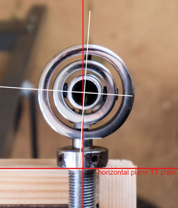

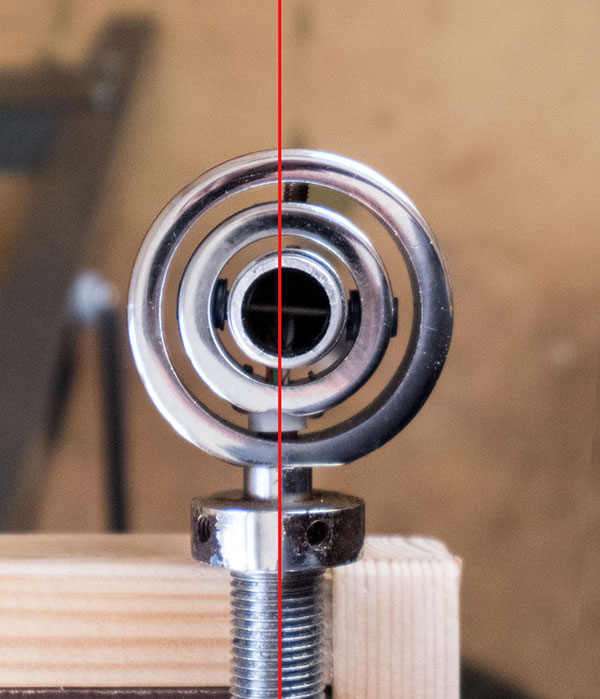

The tonearm has some rust at the base, so one of the fixing(VTA) screws is not going to come off. I tried the massage this for a week - it will not budge. Before I going to drill this out I need some advise about the arm though. For me it looks crocked/tilted. I do not know how it supposed to be originally.

Yes, the arm is damaged. I put it on and the geometry is badly off.

Dillen replied on Mon, Apr 16 2018 6:49 AM
Which geometry? How do you measure it?
And can you show us the damage, you are talking about?

Eri replied on Mon, Apr 16 2018 7:00 AM
There is a picture looking at the rear of the bearing counterweight off in my first post. When cart is on the bottom flat of it is tilted/twisted towards the spindle so the stylus runs tilted as well. I can not undo one of the VTA screws to correct the arm leaning back too much.

Dillen replied on Mon, Apr 16 2018 2:45 PM
I see nothing wrong in that photo.
Can you show us a photo of the cartridge "twist"?

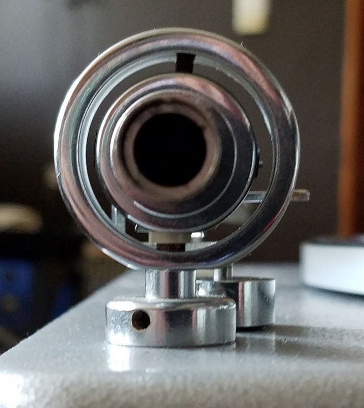

Eri replied on Mon, Apr 16 2018 4:39 PM
Interesting. So the pivots in bearing are not supposed to be horizontal and vertical compared to the mounting post? You see, I haven't seen this Beogram before, so I don't know if it is right or wrong.

Eri replied on Mon, Apr 16 2018 4:40 PM
And the front view

Eri replied on Mon, Apr 16 2018 6:40 PM
Well, that's relief. I put the pictures on the top of another and the angles are identical. Ouff! nothing wrong with the bearing!

I got this sorted as well. Now when I knew that the bearing is OK I just twisted/rotated the arm-tube. It appeared that the tiny fixing screw at the bearing was loose and whole tube rotated a bit. I have drilled out the VTA screw as well and re-treaded. I am going to machine the mounting collar clean from rust(and chrome plating as well) and paint it.

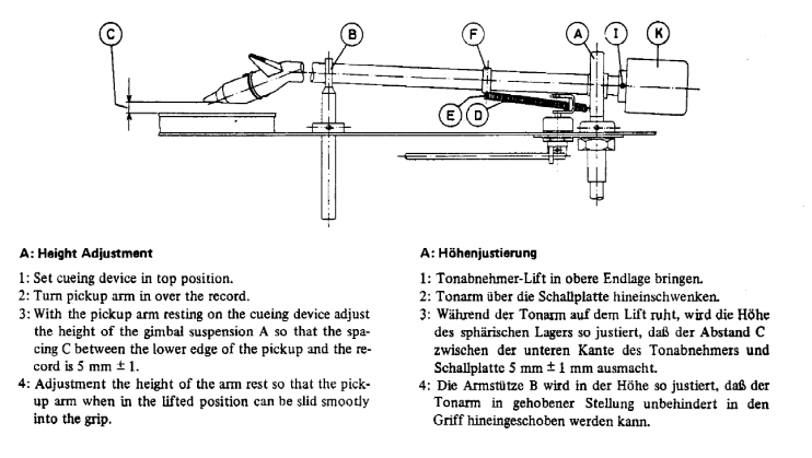

There is a manual onsite for silver and gold members, which pickup are you using ?

Something is not right with this arm. When I follow the instructions I get the situation where the cart rides so much nouse up that the back hits the record surface. Moreover the stylus has a downward bend(I think it is made this way but I have nothing to check with) but it is not enough. Without this bend stylus tip would not touch the record at all.
I doubt that the arm is bent out of shape though.
Søren Mexico
Mexico City
Posts 6,411
SP6/7
Søren Mexico
Mexico City
Posts 6,411
Will this help ?
Søren Mexico
Mexico City
Posts 6,411
Is the TA lift correctly assembled ?

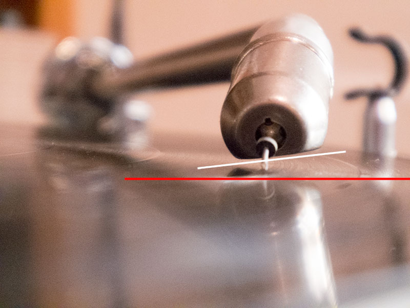

Eri replied on Wed, Apr 18 2018 5:27 PM
So I got it now. Since the arm is angled two ways you need to position it right. The tube retaining crew at the base was loose so I did not know the right position there. But the screw that holds the cartridge mount in place has 3mm slot for rotation on its axis. Now when I twist the tube so that the angle towards the platter increases(counter clock wise) it tilts the cart to the left - the bottom of it is not parallel to the record(see previous picture). However the hight from the platter is OK. Now I loosen the cart mount screw and turn the cartridge along with the mount(clock wise) parallel to the record and all is well.
And it sounds pretty nice indeed!!!!!
Thank you all. I hope this will help future adventurers.

Eri replied on Wed, Apr 18 2018 5:29 PM
The picture once again:
