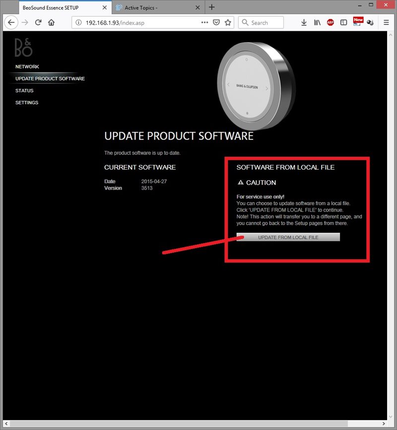

The challenge to win: HOW do we get the 4189 software onto my Essence MK1 to bring it back to (internetradio) life?
This was my main usage scenario with the Essence MK1 and I guess that there are many users world wide that would be happy to have this solved.
The product software is up to date
CURRENT SOFTWARE
Date     2015-04-27
Version     3513
On this update product software page is a manual option, too:
"SOFTWARE FROM LOCAL FILE
Caution
For service use only!
You can choose to update software from a local file.
Click ‘UPDATE FROM LOCAL FILE’ to continue.
Note! This action will transfer you to a different page, and you cannot go back to the Setup pages from there."
This implies that there must be a way to load a local firmware file to that thing!
I did a factory reset (paper clip 10s into the reset hole) a few times but it still refuses to see any new software. The essence is connected via LAN cable.
MartinRK
Posts 80

TWG replied on Sat, Apr 20 2019 8:17 PM
MartinRK:
And where do you see this option for a local file?
In one of the apps? (I don’t see this option in my app) or from a B&O web page ?
You just enter the ip adress of the essence in your browser's adress bar. In this case 192.168.1.93.
Here's a screenshot and I've marked the manual section in red:

TWG replied on Fri, Feb 7 2020 7:43 AM
The Essence updated didn't work at home and Bang & Olufsen support in Struer wasn't able to help me nor did they send me a firmware file for manual updating the device.
But with the help of a superb(!) dealer who downloaded the firmware to manually update the Essence MK1 I got the Essence working.

I have same issue
can you share with me too the file?
TWG
Top 75 Contributor
Posts 1,672
TWG replied on Sun, Apr 26 2020 1:09 PM
MortenB & leonr got mail.
poodleboy
Posts 303
poodleboy replied on Sun, Apr 26 2020 1:34 PM
@TWG, If you could include me I appreciate it greatly. Thanks.
