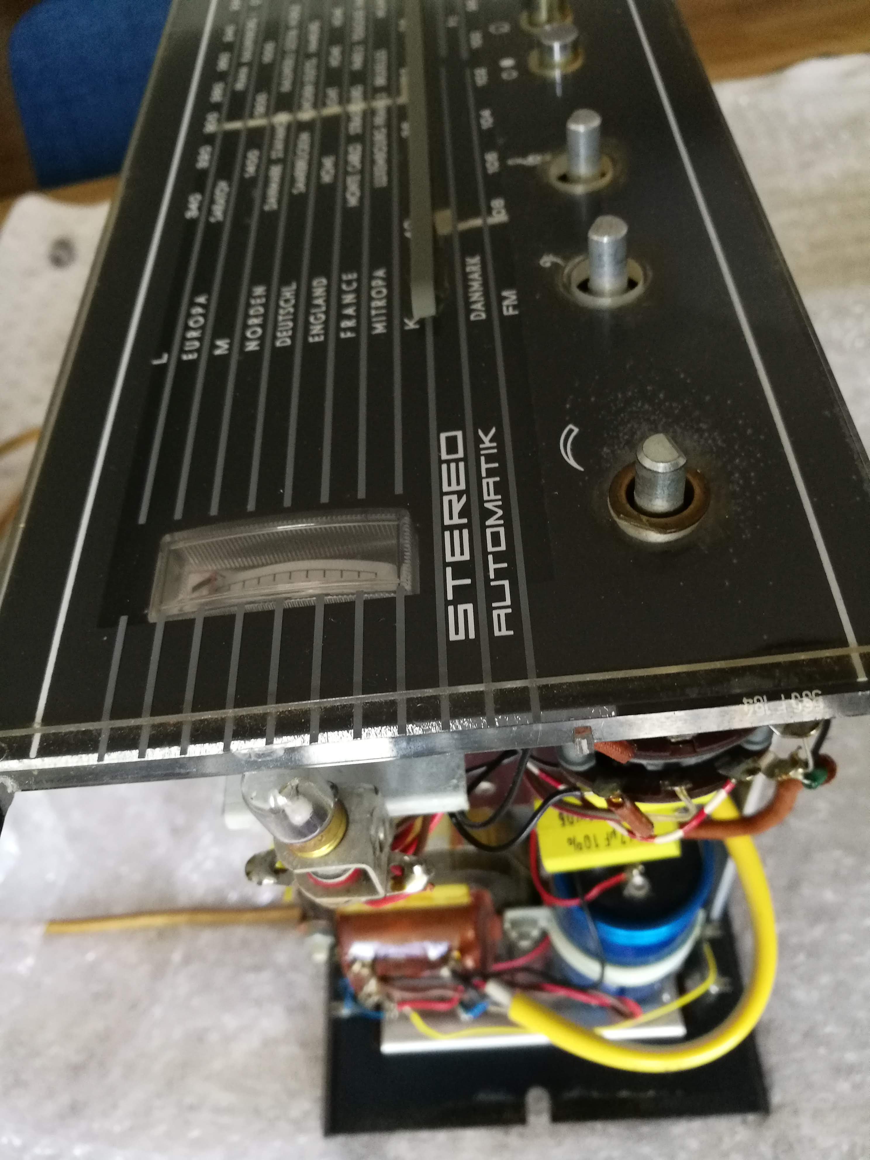

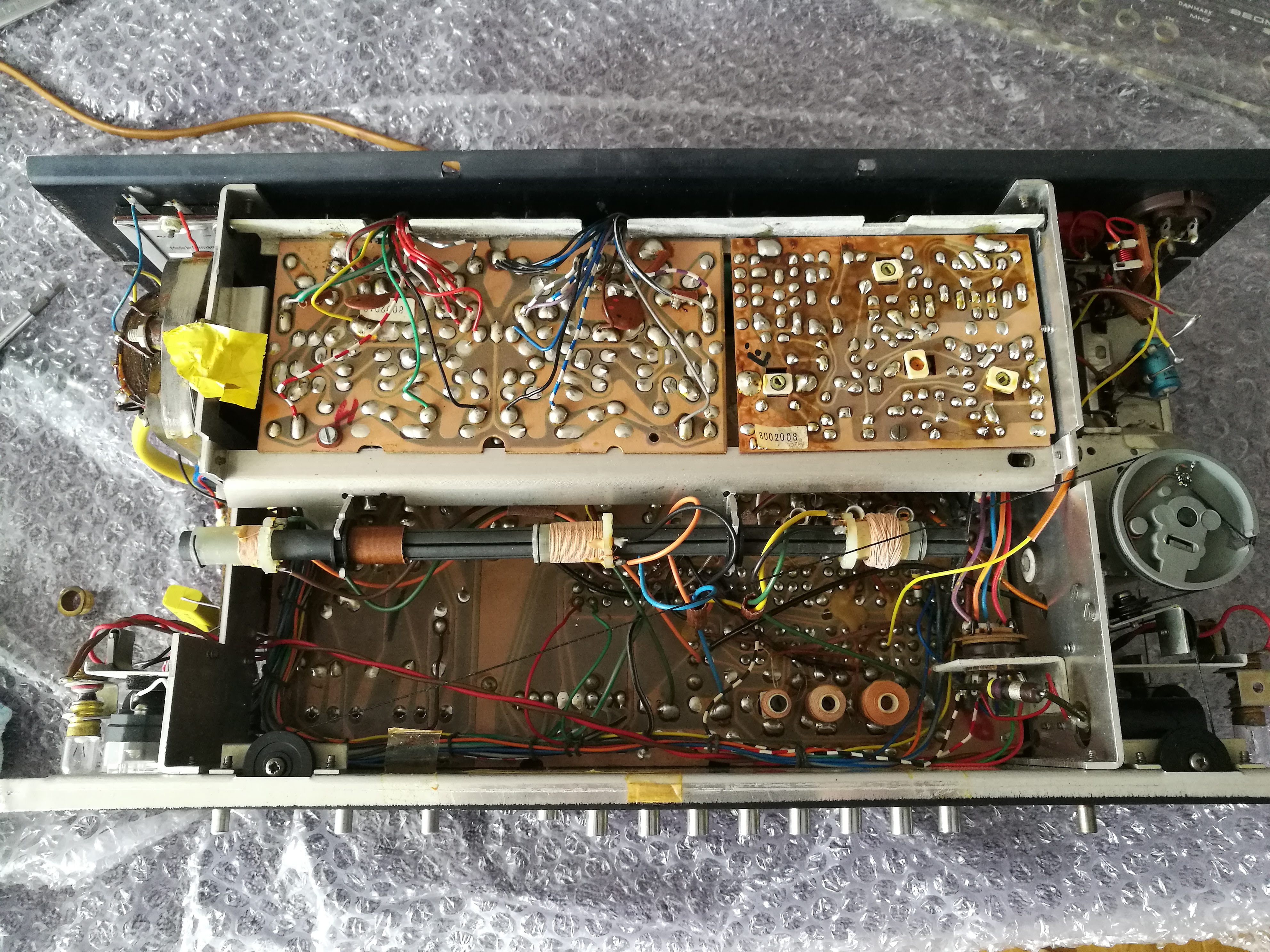

Hi Guys,
my Beomaster 900M has two blemishes on the glass panel:
- there is some kind of spray residue (contact cleaner?) around the volume and tuning knobs, there seems to be some kind of additional layer attached to the front glass panel and this seems to be in between the two layers
- the right end of the plastic rail is broken off.
So my questions to the experts are is it possible to clean the glass panel in that area, is there some trick to do it, or should I look for a replacement panel (donor unit?)? Any help or suggestions would be appreciated! I love the look of this earlier version of the Beomaster 900 vs the later one and would love to bring it to a better condition.
(And it does have a stereo decoder!)
Thanks as always,
Piotr

Dillen replied on Sat, May 26 2018 10:48 AM
The dial (acryllic) glass rubs on the backdrop metal plate, causing the areas with grey "spots".
Take off the dial and polish (only) the affected areas with Novus #2 or similar.
The broken memory bar will have to be replaced, it's glued to the dial.
And the memory pointers seem to be missing.
Martin

peternovy replied on Sun, May 27 2018 10:23 AM
Thanks Martin! The polishing should be easy to do, I do have some polishing paste that I used for my turntable dust cover. The memory pointers of course are missing, but I imagine the only way to replace the bar is to take a complete one out of a donor unit.
So I took the chassis out of the case, but how do I take the dial off?
It seems to be held by something, but I don't want to unscrew the wrong thing - I don't know if I'll be able to put it all back together if it falls apart! :)

tournedos replied on Sun, May 27 2018 12:04 PM
The answer is very near in your photo. That metal thingy around the volume pot shaft is a nut. As far as I remember, there’s another one around the tuning knob, and removing those should do it...

Dillen replied on Sun, May 27 2018 4:21 PM
What Mika just said - and some Beomasters also have short pieces of black tape from the dial edges to the chassis.

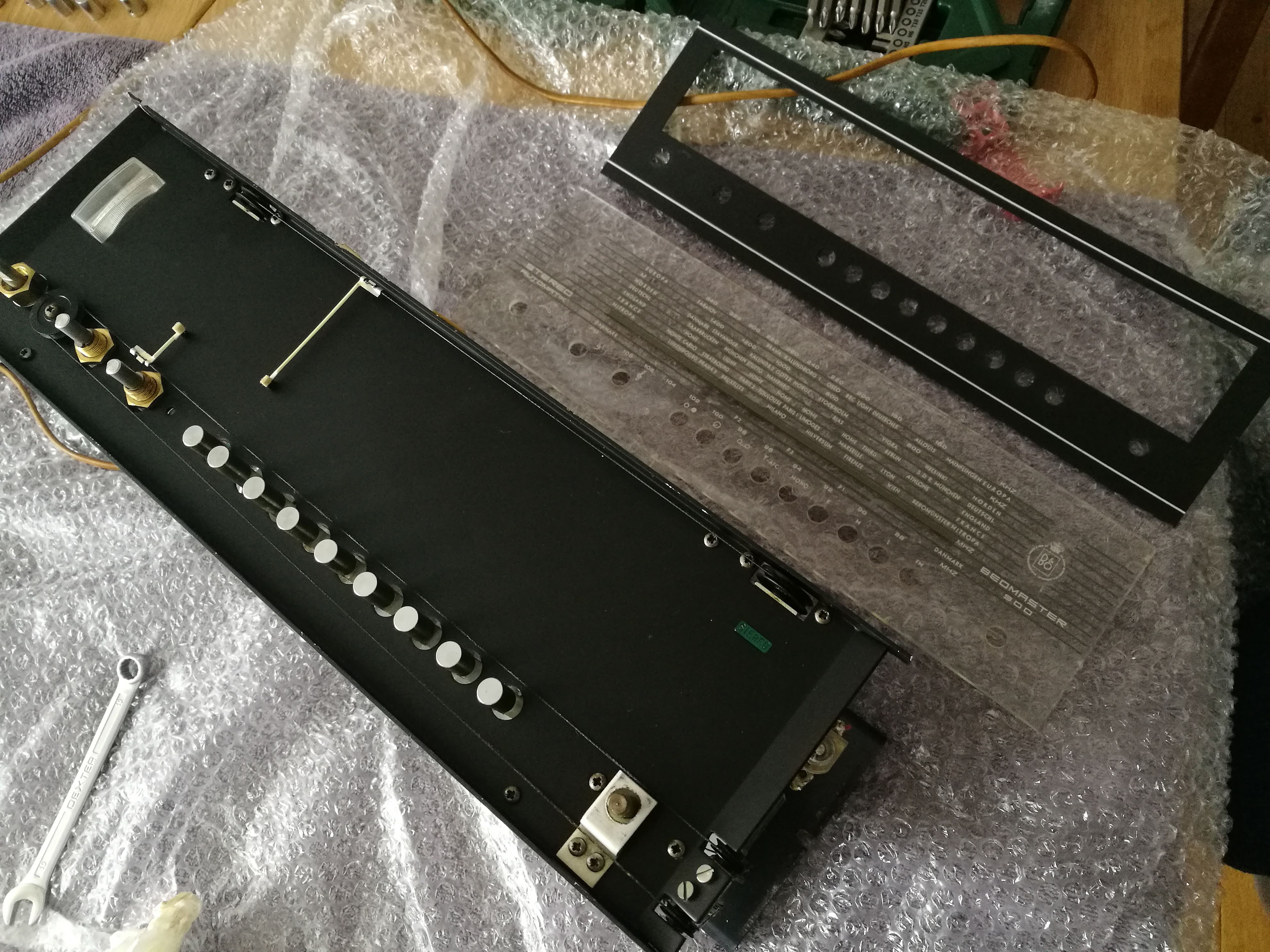

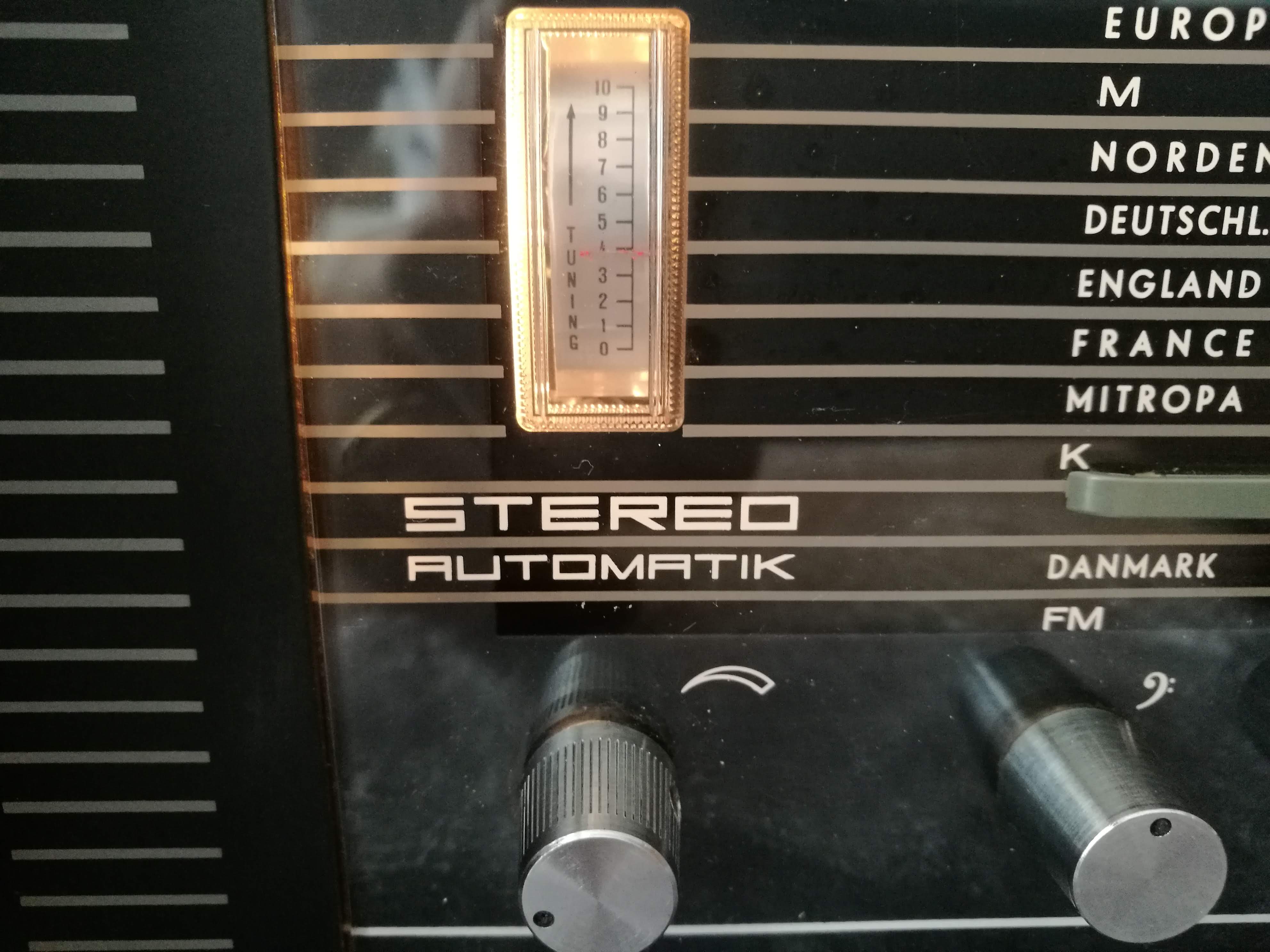

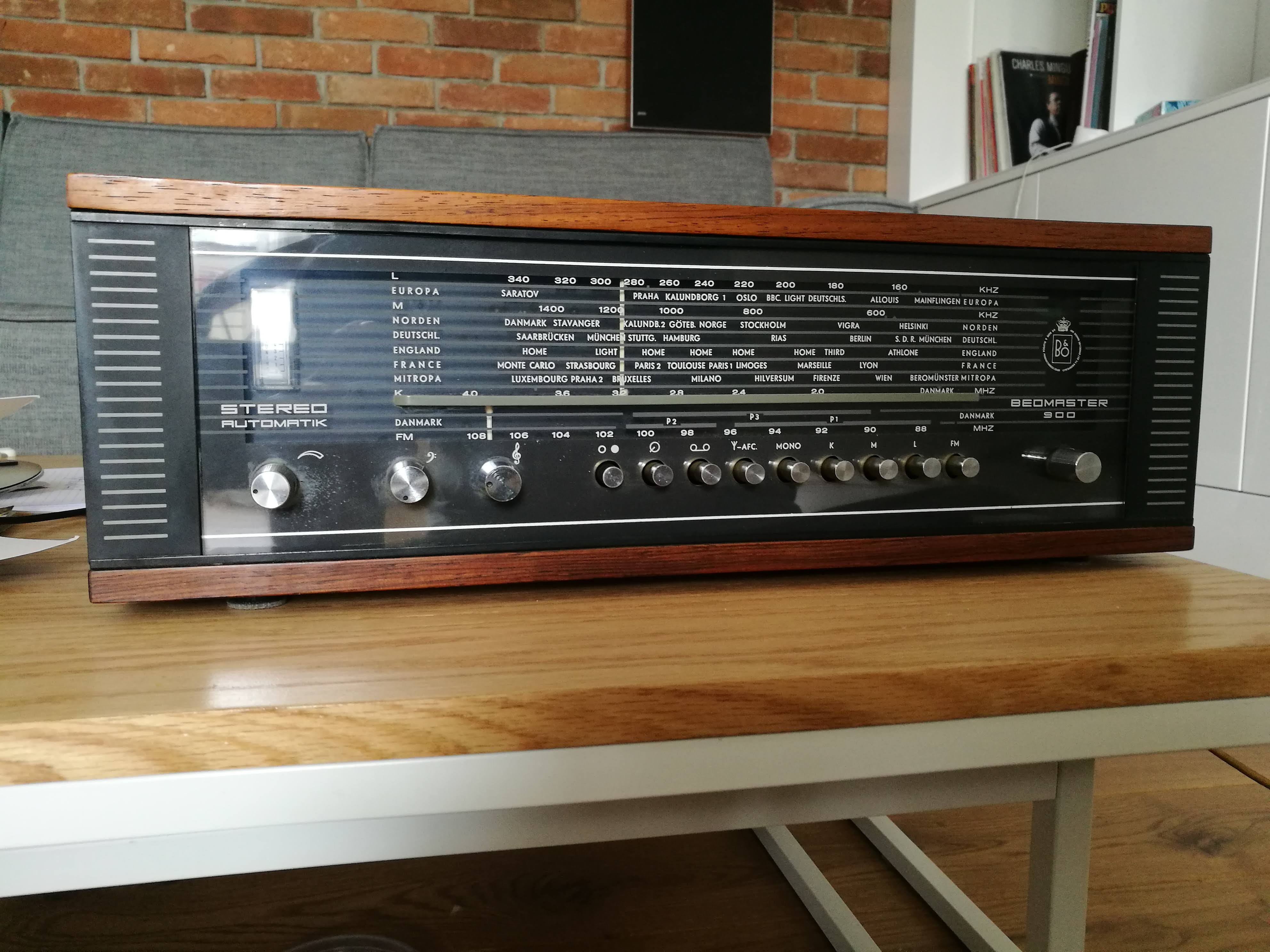

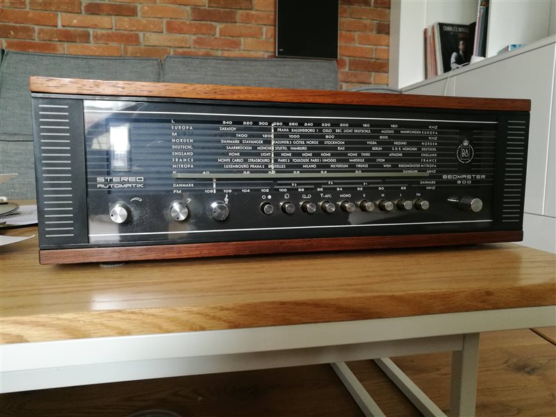

peternovy
Posts 53
peternovy replied on Sat, Jun 30 2018 1:28 PM
Ok, so it took a while to find the time for this, but finally I did and took the panel off. It turned out that it was only some residue, probably from a deoxit-type spray, that essentially I was able to wipe off. I also took the opportunity to clean the panel, the knobs, buttons and so on, so that it now looks a bit nicer :) Thank you very much Mika and Martin for the advice! As usual it was spot on! The only thing left is the dial bar with the markers, but I can live with it for now until I find the part or a cheap donor unit somewhere online.
