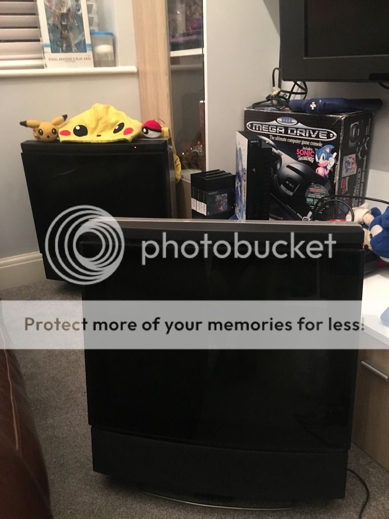

Wadeya001 Posted: Sat, Jun 16 2018 9:15 AM
My MX4000 has a green hue on the screen if a RGB SCART is connected. If I connect RCA via scart or wiggle the scart it doesn’t happen? Thinking either dodgy connection or it’s in composite mode and I don’t know how change it??
My MX4002 is fine???
Here is me adjusting the scart on the back
https://instagram.com/p/BkFBHoNHWQi5Bf_lJPM-daY8TT9W1mGdz3C-II0/
And here is me swapping between a rca and rgb scart connection
https://instagram.com/p/BkFBTxiH6gDy--5-tBVzWuQC8-2WyLWA96cVOE0/
