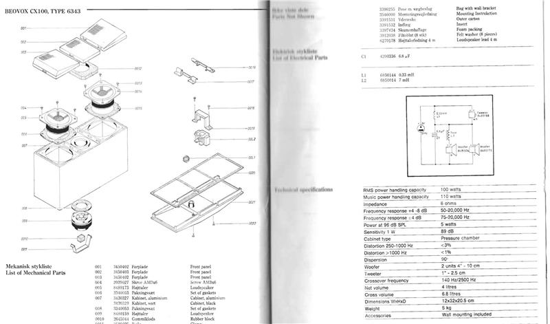

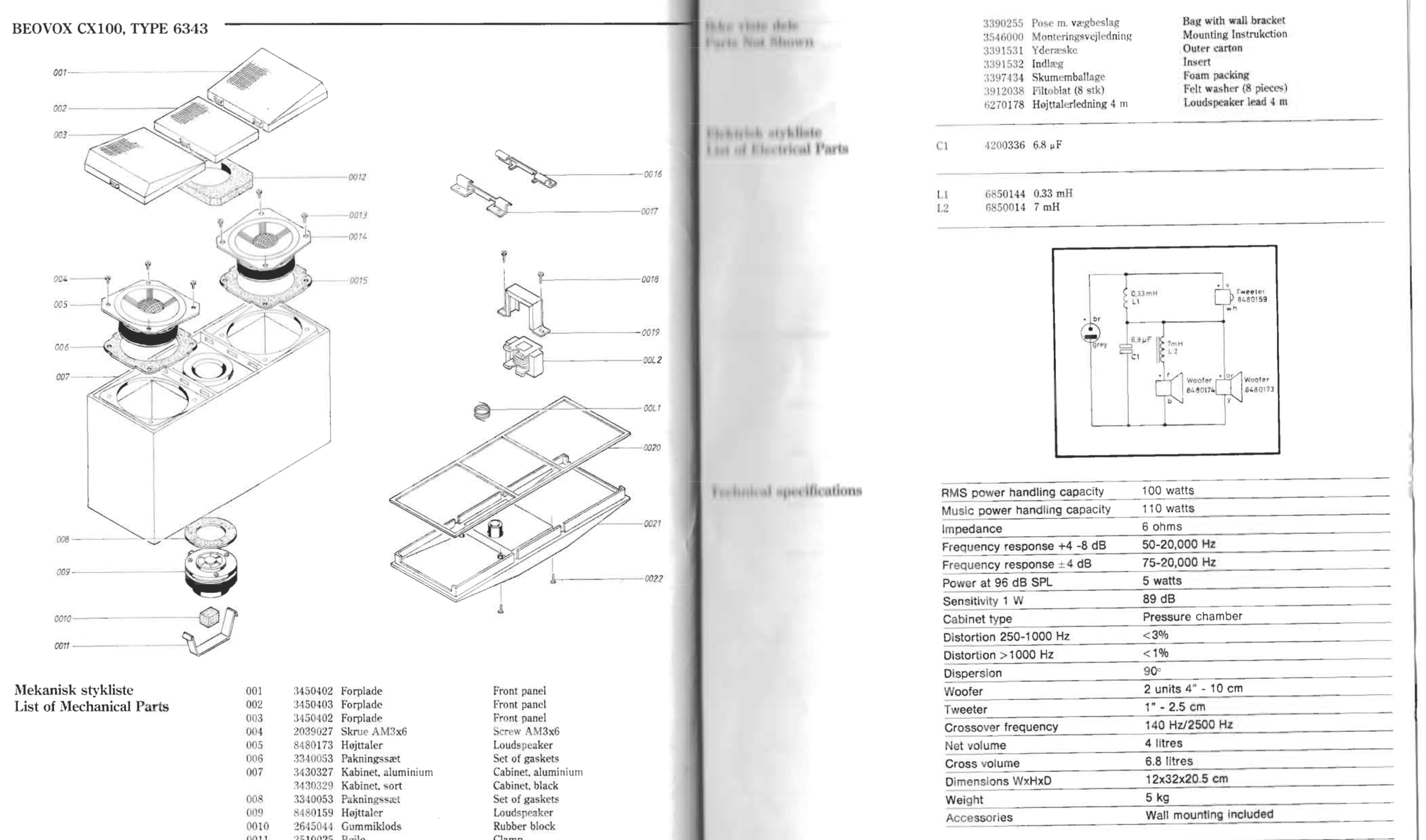

Ok, here is a page from the CX100 manual that states explicitly: "Power at 96 db SPL -- 5 watts". In this case sensitivity is also stated in the usual way as 89db, and both figures, of course, agree.
The part about 96db SPL is not stated explicitly for the older models, but this is a good indication that this is how B&O measured it. Also, it corresponds to the performance one could expect from the various models, e.g. S50 are 4 watts, meaning 90db, but the MS150 are 2.5 meaning 92db as being TOTL.
