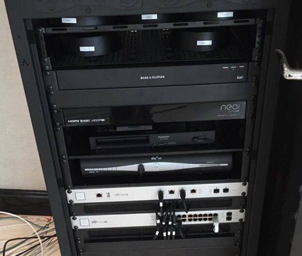

w5bno123:Just out of interest why would you not look at the BeoAmp 16 and use B&O amplification for the BS Cores? It works a treat and only takes up 1U in an AV rack. You can bridge multiple outputs to one BS Core as well. Here’s one on a rack below the Cores. Regards Stuart
Greetings. I couldn't expand the picture enough to understand everything beneath the cores and amplifier. What else does that system do? It seams quite compact for the service offered.
poodleboy:Greetings. I couldn't expand the picture enough to understand everything beneath the cores and amplifier. What else does that system do? It seams quite compact for the service offered. BS9000, Essence, BeoLit12, MX4200, BL3000, BV11-55
Regards
Stuart

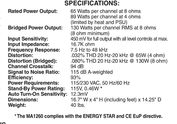

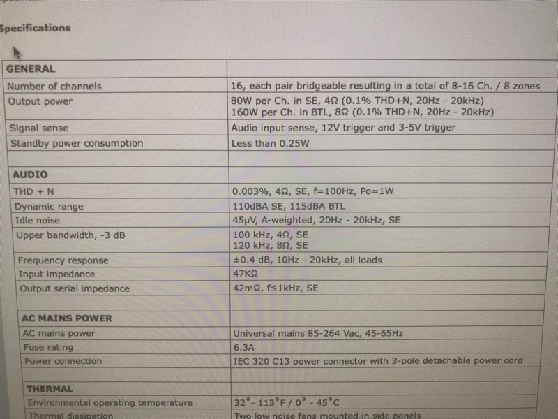

lonfred:What I could see so far is that the Dayton amplifier is much more flexible regarding settings than the BeoAmp 16 and I really like the two RCA Bus connection that is has. The Dayton amp also seems to give more power than the BeoAmp where each channel of the BeoAmp only has 25w (400w/16) meanwhile the Dayton gives 65-89w per channel.
w5bno123:Here are the specs of the BeoAmp 16 detailing power outputs per setting. I hope this is useful.
