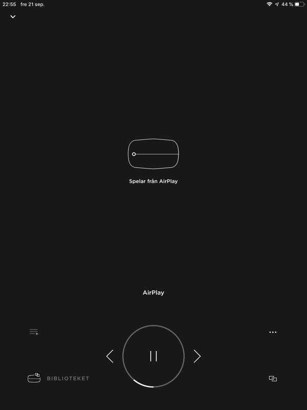

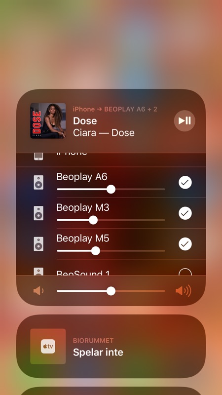

Hiort replied on Fri, Sep 21 2018 6:53 PM
This is the way I play.
Play from iPhone using Deezer app:
Tick the speakers I want to Airplay to:

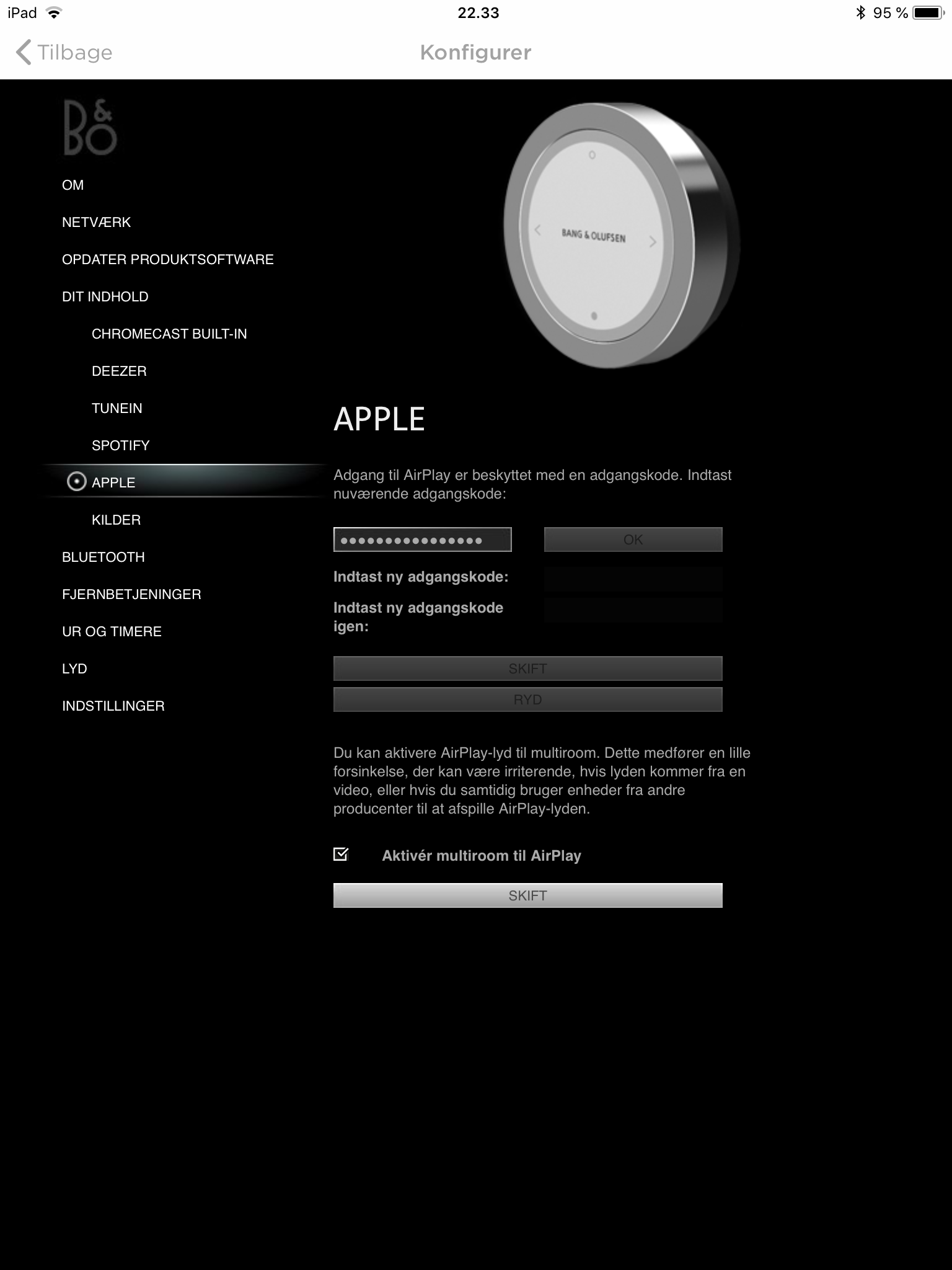

I looked at the product settings / configuration - and the option, under sources, to allow airplay multi-room has disappeared.
Which is why i think it now doesn't work.

As mentioned earlier, i can't find the "enable multi-room for Apple airplay" option / checkbox. The used to be in the Product Settings / Config part of the app.
For some reason it's gone (unless i'm going mad), and i suspect that is causing the issue.

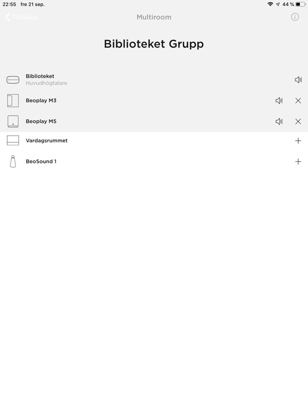

Hmm...
I’m airplaying to A6
And I can expand to my other speakers using the app:

The "Enable Mutliroom for Airplay" option has been moved in the Settings section (i'm on beta for app and AP2 speakers)
It now sits under Settings / BeoLink / Sound Synchronization.
The additional feedback i got from support was this
"It has been disabled since it result in drop outs when using more than 2 products in AirPlay2 and BeoLink MR setup."
So, it seems it has been disabled by default for the reason above (?) - though you can re-enable it.
It now works again for me.
