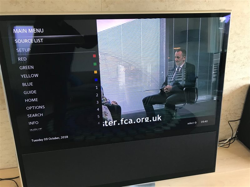

How does the overlay look like - could you post a picture?

Finally managed to upload a photo MM.. The 4 colour buttons do nothing when pressed.

I searched and found that there is a version of the Sky Q remote that actually has red, green, yellow, and blue buttons. It looks like the PUC was made to directly correspond to those colored buttons. What happens when you push numeric buttons for functions such as GUIDE (1) and INFO (5)?

Buttons 1-9 do work, guide & menu work on the Beoremote one, fast forward, play pause etc also work. It’s just the colour buttons that seem to do nothing.

I suspect that the color buttons are used only when you have options to use them on the screen. For example, my set-top box (not Sky Q) has buttons for A, B, C, and D that are listed on the menu overlay. They are only relevant when I'm doing something with the set-top box that provides those as options. In your case, I think it's a waste of use for the color buttons since those buttons can be used without pressing "home" first. Perhaps not the best design of the PUC in the case of Sky Q. At least you know you can have the functions for guide, info, etc. when you press "home" for the menu overlay. Hopefully, the "guide" and "info" dedicated buttons on the BeoRemote One work for you.

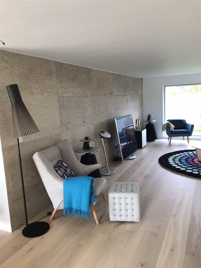

The setup has Beolab 3s on floor stands opposite it. We have only just moved into our recently refurbished typical English 1980s house now converted into a Scandinavian hybrid :-)
I will get some photos together pre build, pre install etc and start a thread with the other B&O installations throughout the house. Just need to complete a few things first.
