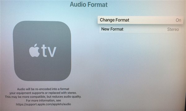

matador43 replied on Sat, Nov 10 2018 1:21 PM
Have you tried to set (if possible) the audio output of the ATV to Linear/PCM?
Sometimes those littles box can't decode dolby encoded audio streams.

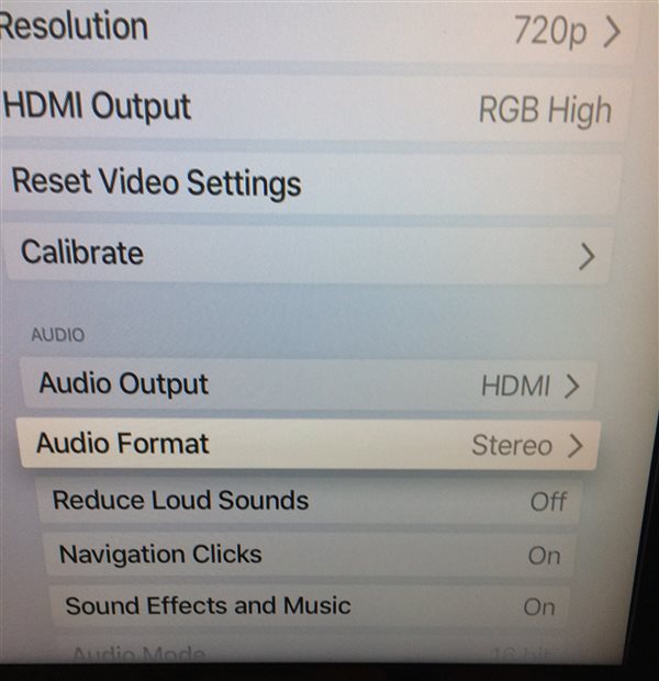

Guy replied on Sat, Nov 10 2018 1:33 PM
Here's the settings of my ATV4 (running IOS 12) using the audio extractor that I mentioned earlier:

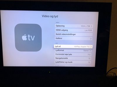

I do not get the same option in the menu - still think it could be relating to the EDID that your converter support and the one I have do not.
Will try to connect the Apple tv to another TV directly on HDMI and see if menu is different.

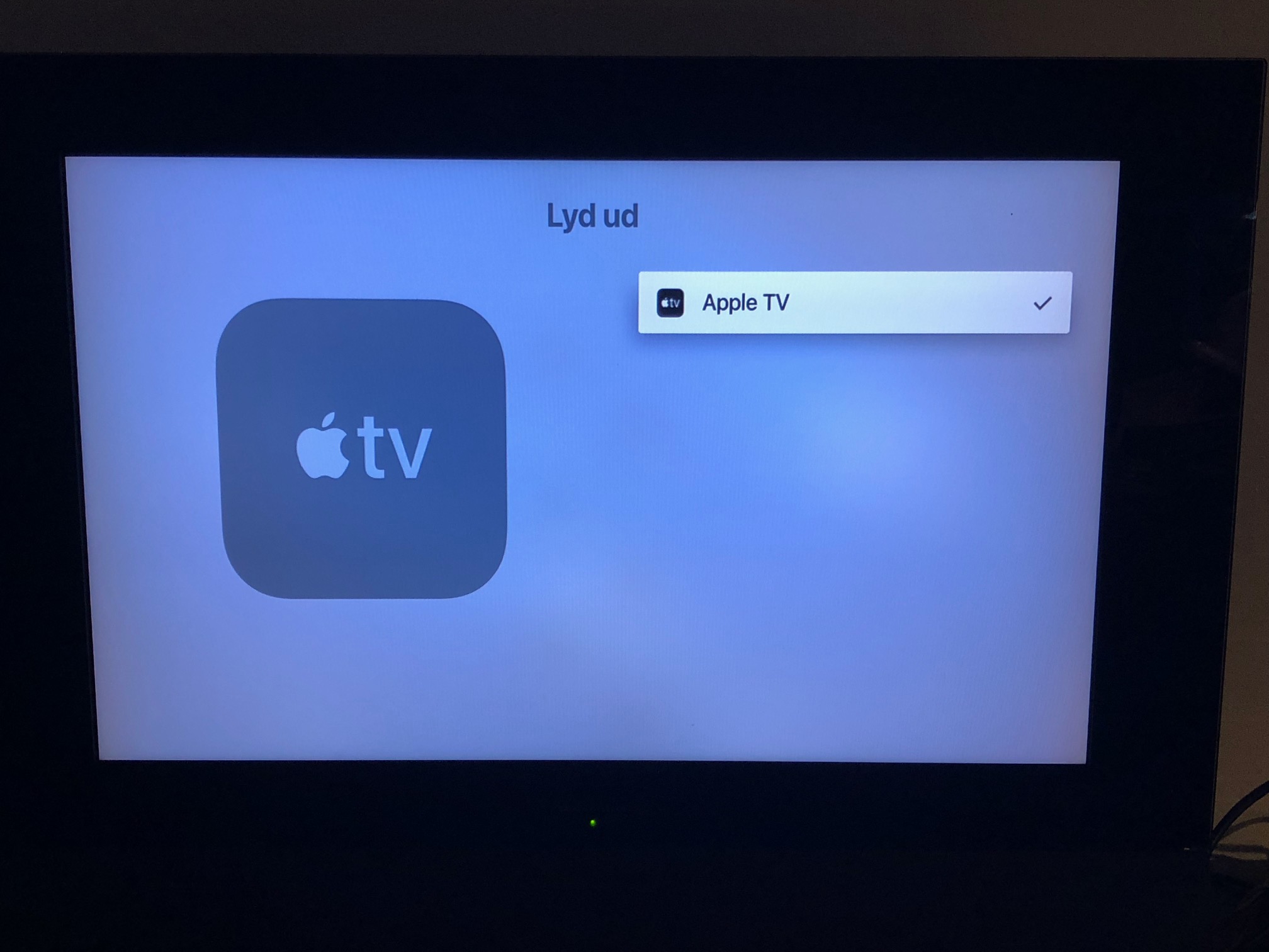

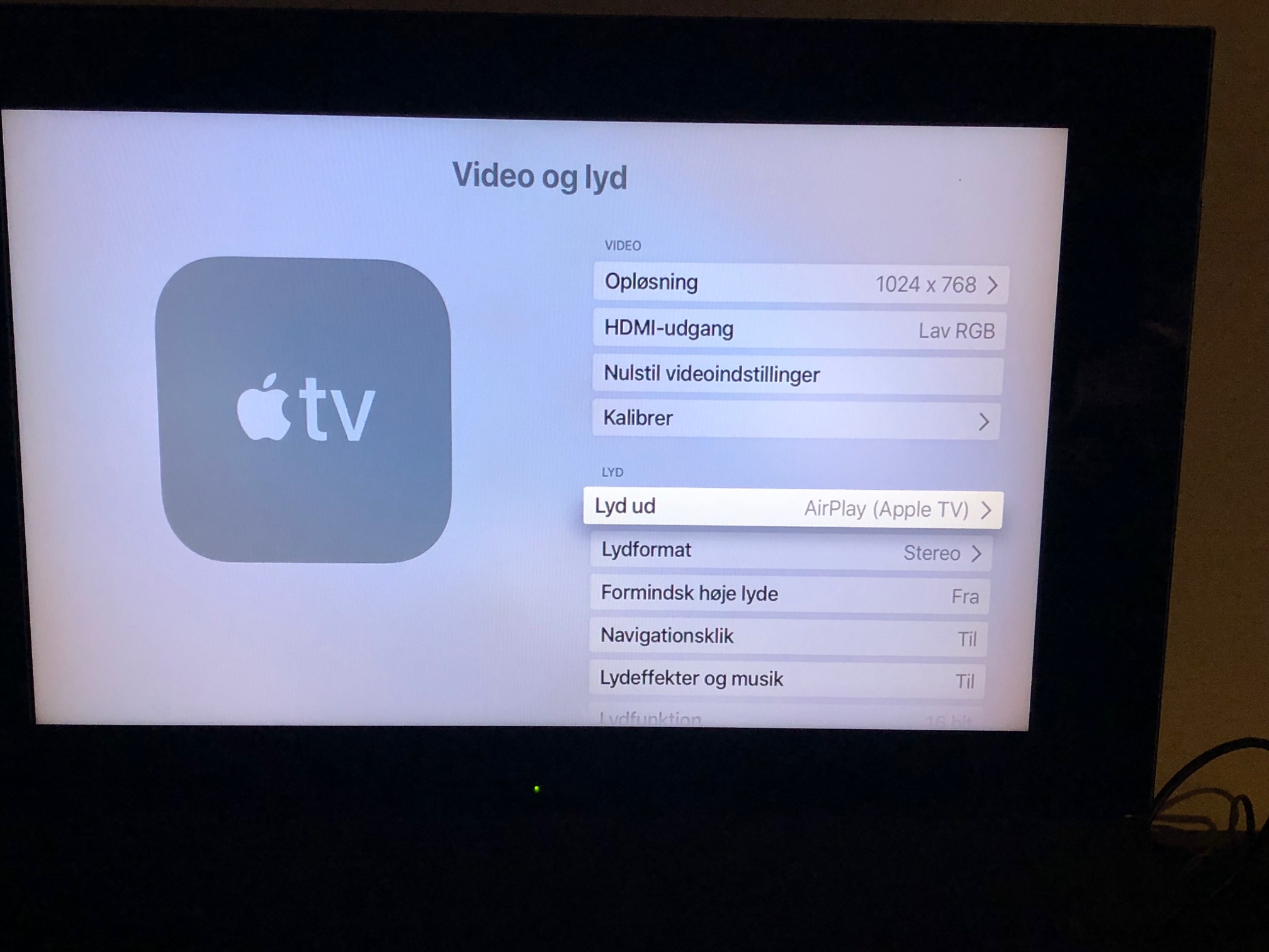

I just checked and mine's actually at IOS 12.1 - is yours the same?
Also, your 'Lyd ud' suggests that it is airplaying to another Apple TV' - is that possible?

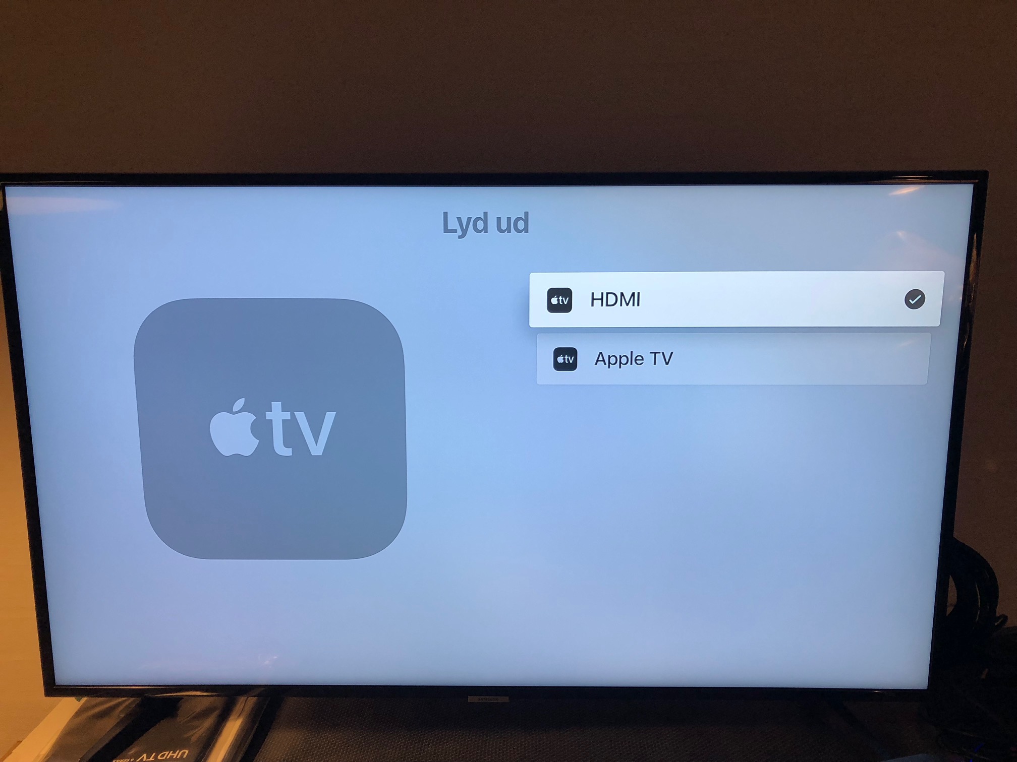

Yes I have a appleTV hooked onto my avant55 also.
Have now tried with a samsung TV, AppleTV trough the HDMI converter I get the HDMI option in the audio option.

Yes I have an Appletv hooked up ti my avant 55
Tried to connect the AppleTV4 to a samsung via the HDMI converter  - and I now get the HDMI audio option on the appleTv

Guy:
My point here is that, if your (BV6) Apple TV is airplaying to a second Apple TV, then it does not provide audio over its hdmi output, which could explain your problem.
