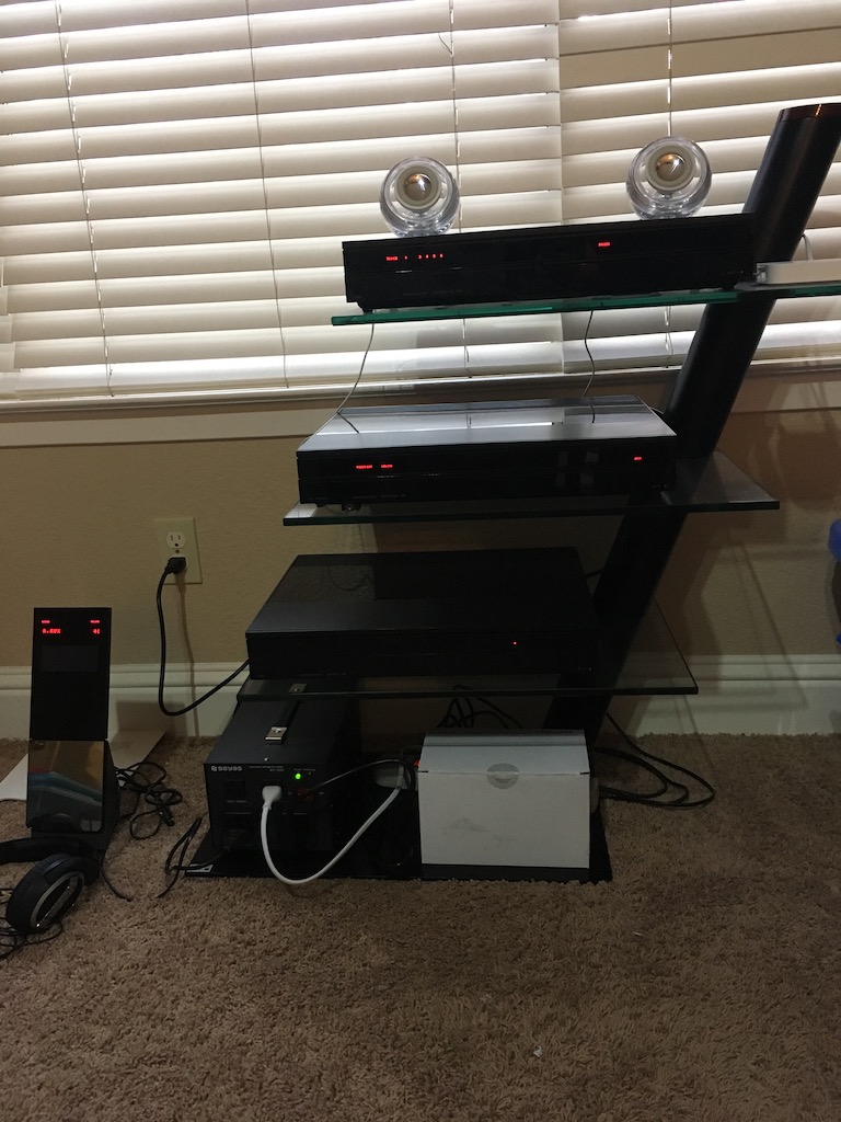

After a year being packed away and a move half-way around the world, I finally got my Beosystem back up and running with a 220V step-up transformer. I tested it with some old Apple pro speakers I had been using with my laptop. The Apple speakers sound surprisingly good, much better than on my computer, but I ordered a pair of Dali Zensors and am looking forward to once again being able to enjoy this wonderful stereo. I'll just leave it on 220v as it works perfectly with the transformer and I might move back to Europe if the right opportunity arises.
