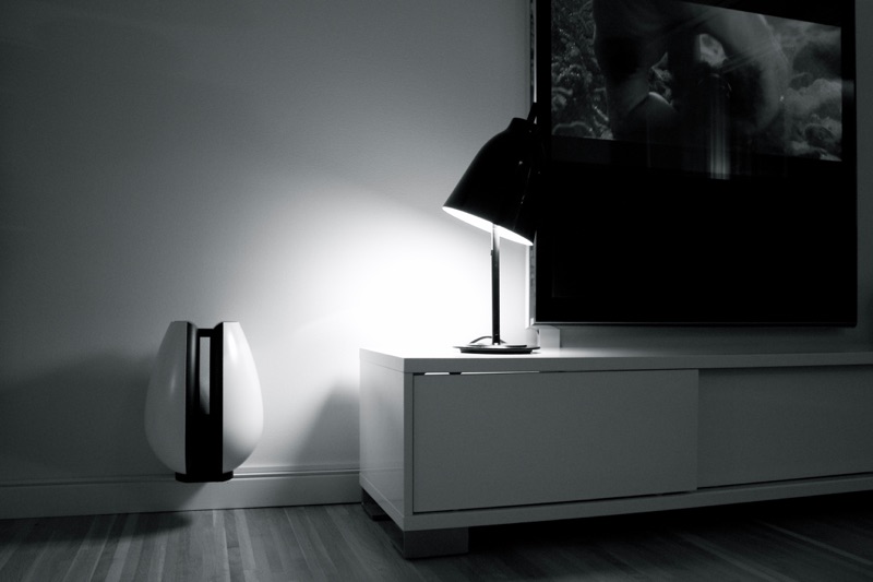

Not with my 3’s, but I have one with the 6002’s in a rather smallish room (using the basmanagement of the BSystem 4).
It blends perfectly in with the other speakers just like a sub should do.
I’d like to have two of them ๐ Maybe some day!
Two subs always helps to avoid standing waves/room modes in a room.
