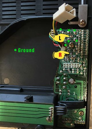

The aux-in pins are located on a little PCB on the casebook. All the needed connection are there:
Left in, Right in and common ground (you can take the ground wherever it suits you, just pick one!).

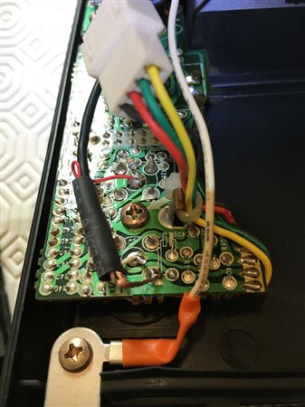

Then solder the jack wires

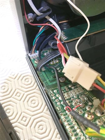

The difficult thing if you use a wire with naked ground like me, is to avoid any shortage as the pub is quite crowded. Here you can see red wire to the right channel, white wire to the left channel and the ground, protected with a thermoretraclable sleeve.
I've still add some crazy double protection, not my finest work!
Then tuck the jack through the PCB and the holes in the battery bay.

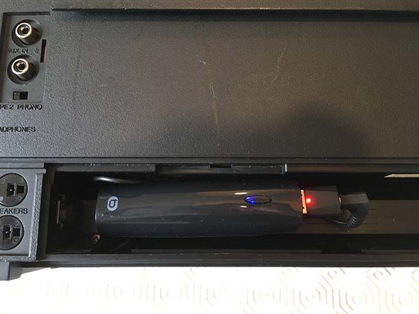

Close the BS10, add the power bank and the USB BT dongle and voilà!
Now you can access the Beosystem 10 in Bluetooth by pressing the "aux" key!

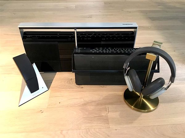

And here is my little B&O bluetooth family:

matador43:
I enjoy your fun Bluetooth projects. Especially since they are reversible
