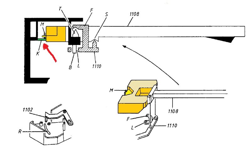

I've just get a Beolit 707 slider 3d printed by my nephew.
The model seems to be accurate and it works but we still need to wok on aesthetically aspects and print quality! Big Smile
I've attached the model to this post.
W.Frankenberg / Gandalf
Heilbronn / Germany
Posts 290
I habe exactly the same Problem with one oft my beograms (See my post Form last year beogram 3500)!
Is this 3D printed part available?
How can I get 1 vor 2 oft this part?

I habe exactly the same Problem i need this part!
Heilbronn / Germany
Posts 290
Big Smileyes the part is signed with a red arrow in position K
wilfried
Heilbronn / Germany
Posts 290
How can I buy one or two or this parts?Confused
