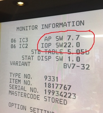

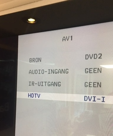

A mk1 can be supplied with a hd-ready kit afterwards, so you can't judge this by the cover or serialnumber in this case.
The way is to check that the BV7 has the proper softwareversion 7.x. If it still has software 6.x then it is a first gen BV7.
The the easy way to look is, you should be able in the setup/sockets menu  DVI or YPbPr.
The analog sound will go through the choosen AV1, 2 or other choosen one.
AV4 has 2 phono sockets for audio, placed vertical.

You can check the software version.
Your typeversion will probably be 731x.

When you select "PC" on AV4 (which can be changed to other sourcenames), then you can use the phonosockets for left and right.

In the setup menu it says YPbPr, and not DVI. However, it does have a DVI socket on the back of the TV (no VGI). Was there a DVI socket from delivery with the Mk1 model?
How can I find out what software is installed? I can not find it in the menu.

Beobuddy:
How do I find the Monitor information in the menu? When I press menu, I only get the information below:
TV SETUP:
Program Groups
Tuning
Play Timer
Options
Stand Positions
