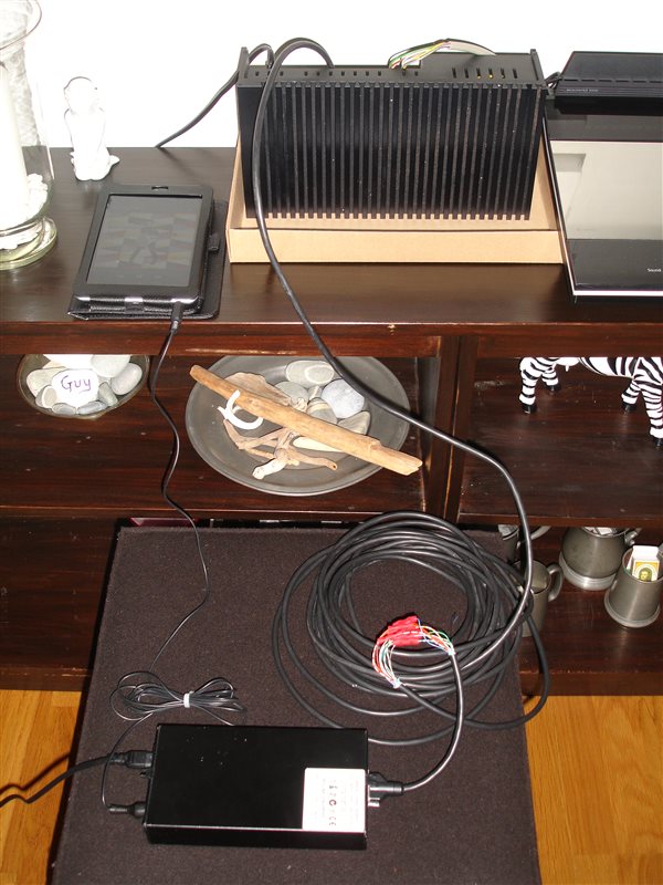

Guy replied on Sat, Feb 16 2019 10:43 AM
I tried to use one of those junction boxes a while back and found it much too fiddly to connect.  I needed to join a couple of ML cables to test something for a fellow forum member, and ended up cobbling the leads together with some crimp terminals - normally used in 12V car electrics.  Worked very well!
