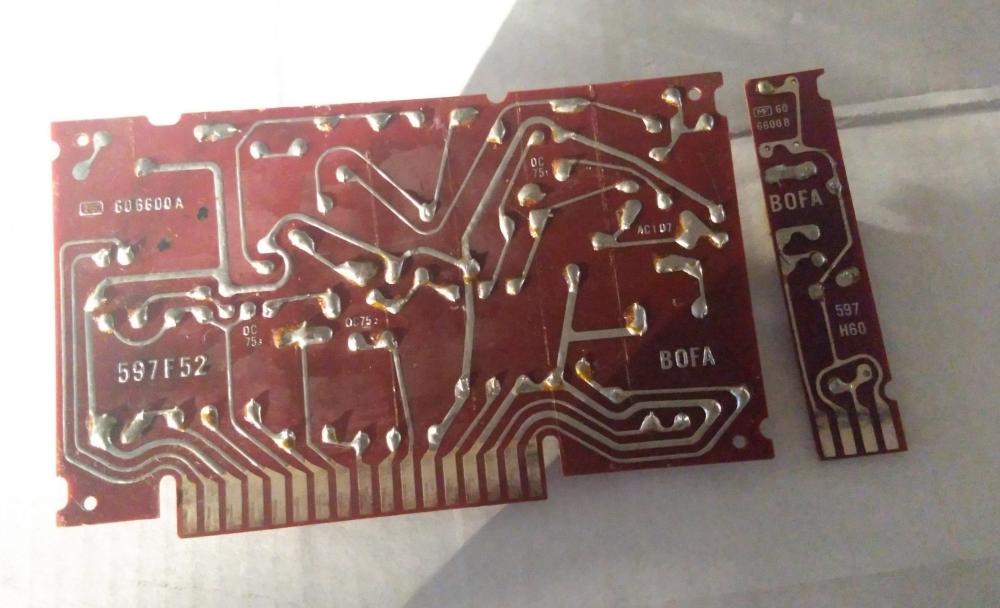

Has the two preamplifier boards (915H23B) been removed or bypassed?Can you tell, if 915H50 (adapter for crystal pickup) or 915H24 (adapter for B&O SP2 etc. and some Ortofon) is fitted?
Thank you for trying to help me.

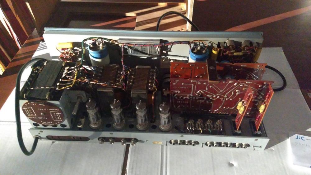

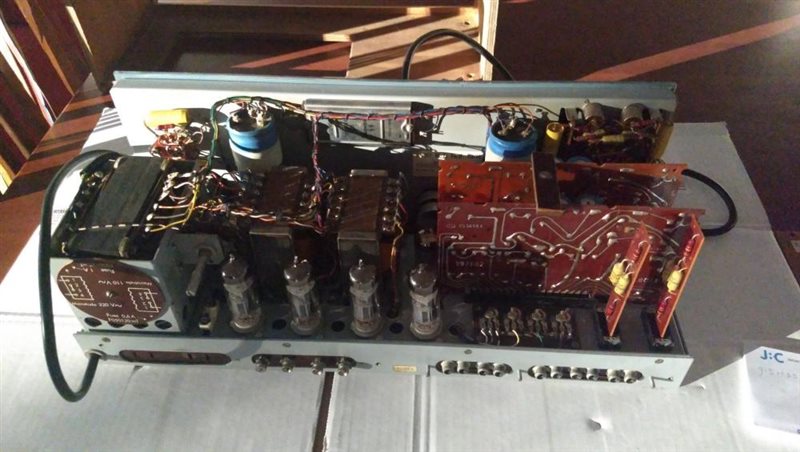

Unfortunately, I didn't recognize the codes you gave me and because I'm not really tech-savvy I decided to upload some pictures. An overview and plates with numbers (597F52). I hope that helps.
