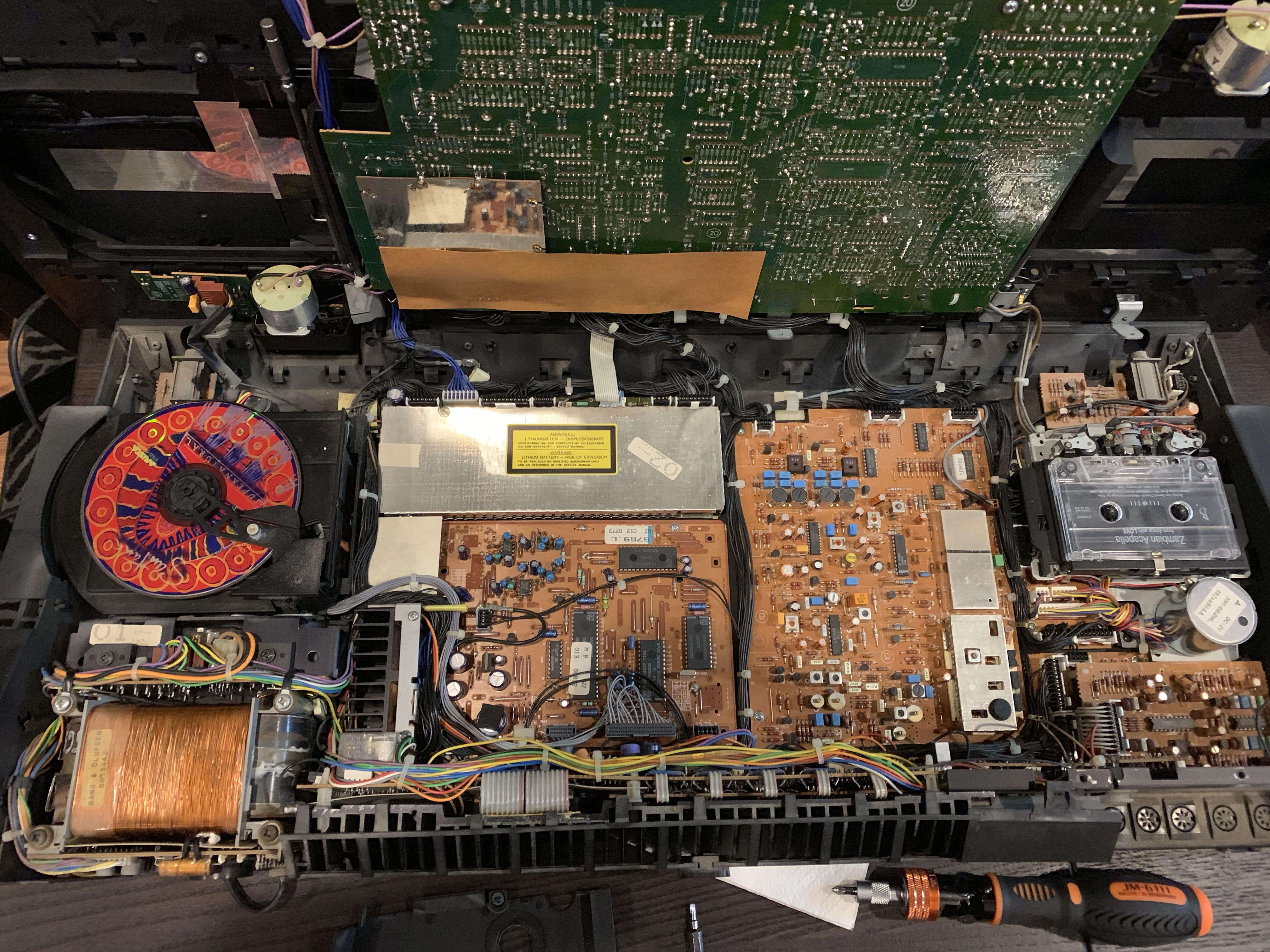

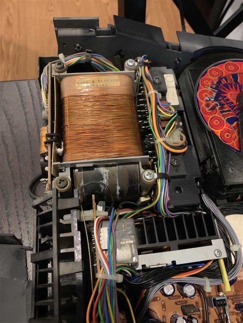

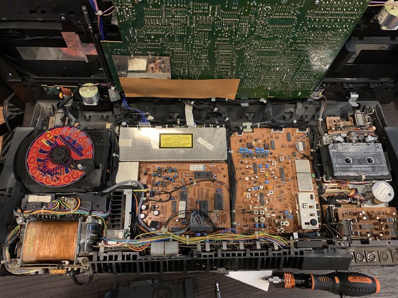

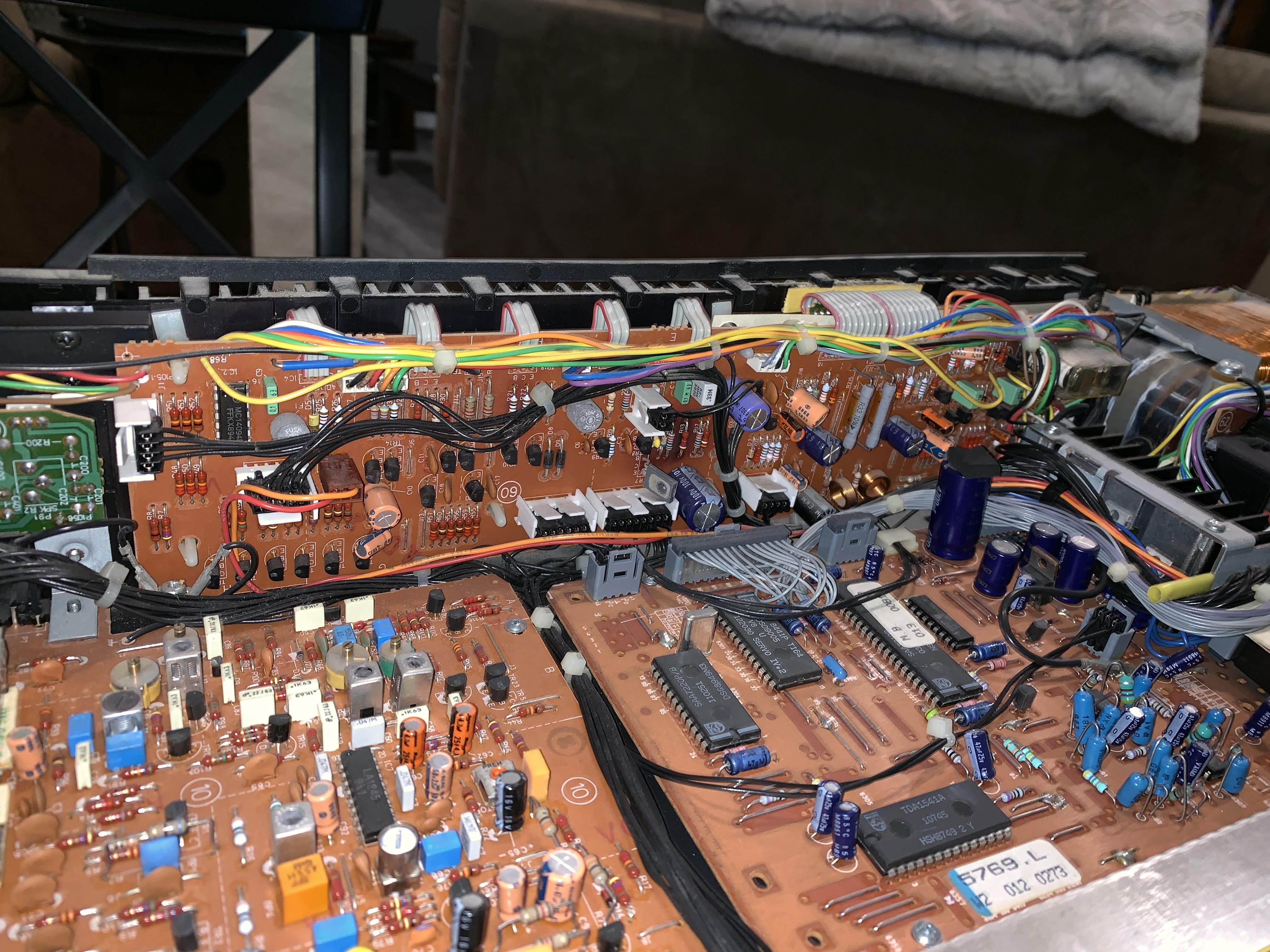

I've opened to unit and the only obvious things are that the entire unit is littered in dust so I will be using some Deoxit to clean it up a bit. Also, as seen in the picture below, the transformer has some sort of liquid that I believe is paste down one side, but it's not running - it seems to have solidified in that position. However when I look at images of other people's transformers I don't see that liquid there. Curious if anyone has seen that before?
Otherwise I'm open to suggestions. I've taken the rectifier board out to check voltages as well as the caps for leakage and they all seem fine on the outside. The transformer was originally set to 110V, but I've changed it to 130V to better represent the ~122V from our house. This reduced the smell a little bit but it still smells like hot electronics.
Below are some pictures of the unit if it helps at all. I am completely new to this design but I do have a background in EE so I'm willing to take things apart and check them out, just not sure where to look. Thanks for any responses!

TheTinman replied on Mon, Mar 4 2019 10:55 PM
That is part of the resin used to pot the transformer.  It's normal.
The "smell" is a pretty unique smell that most old philips based electronics have.  All of mine have it and it never seems to completely go away.

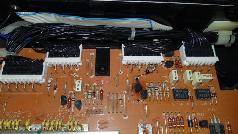

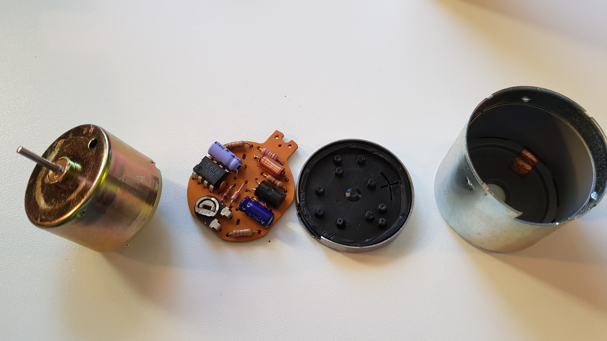

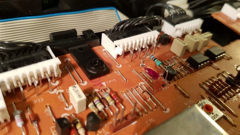

I've had a bad smelling in a BC 9500 caused by Rersistor R 131 ( 22 Ohm) on the PCB wich is placed in the upper  "Bonnet".
It is a Resistor wich goes directly from the Rail Voltage (13,8 V) to the Capstan Motor of the Casette Deck. I could not figure out what the resistor made burning but i have taken the Motor apart and relubed it as far as i came to the Bearings. Also I pulled out the capstans cleand and relubed them.

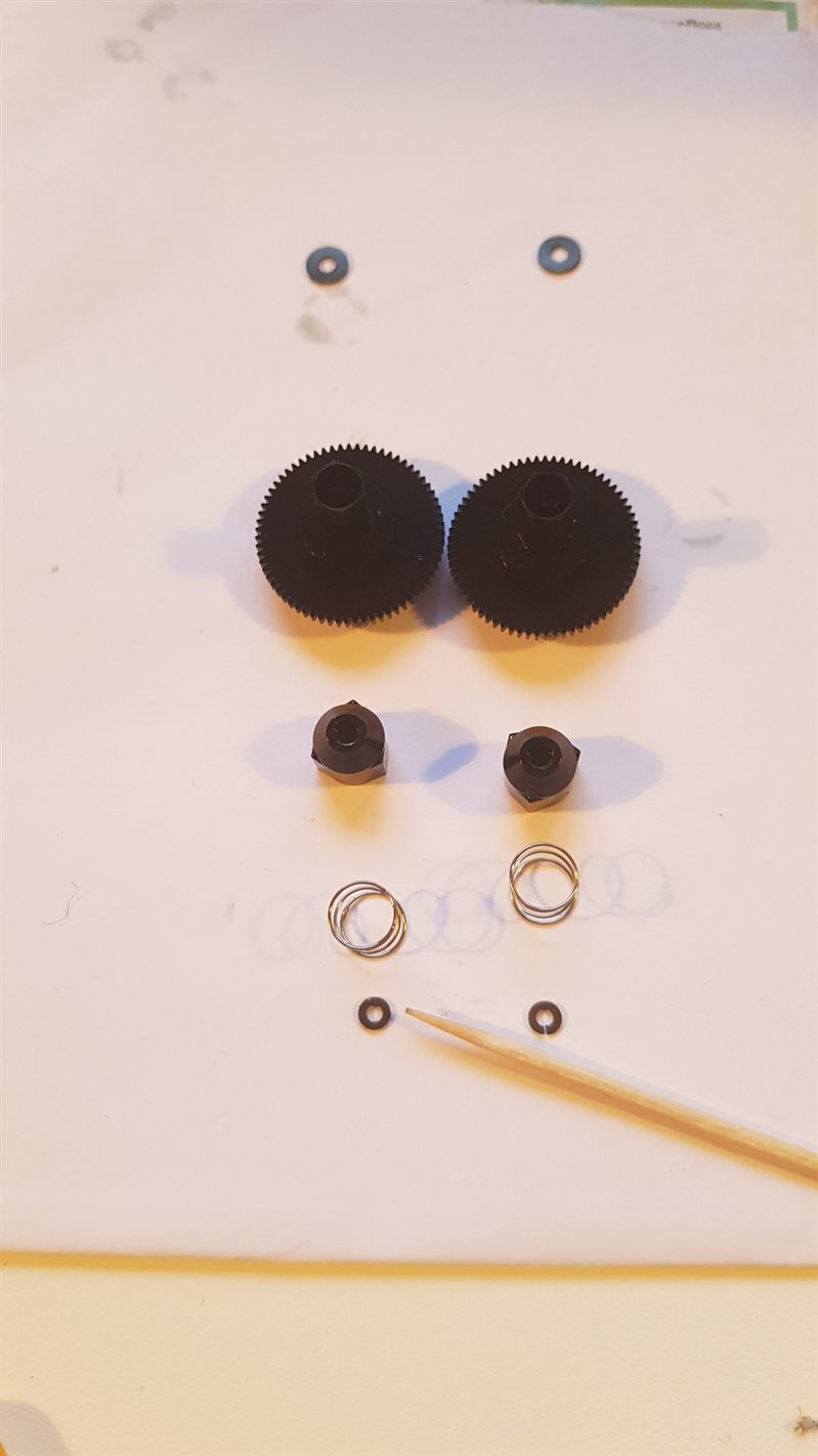

The same I 've made with the Fast forward and Reward Pulleys.
But beware of the tiny plastic Ring wich holds the Pulleys on their Axels, it easyly snaps somewhere  and is rather hard to search for, I've made this expirienceCool
Also I mounted a new Belt.
The Deck is in my case the one with only one Belt.
The Casette Deck is always initialised by the Microcontroller when the BC 9500 is connected to the Mains and the Capstan Motor runs for a short time.
The resistor burned right about 2 or 3 seconds  after connectet the BC to main, not always.
Here are 2 Pictures, one of the burned Resistor and my repair attempt
Since the new Resistor and the new Belt is mounted and everything is cleaned and relubed I've had no Problems anymore with this Resistor or smelling.
The Motor:
The Pulleys, the toothpic sows to the Plastic Rings wich hold the Pulles in Place.
