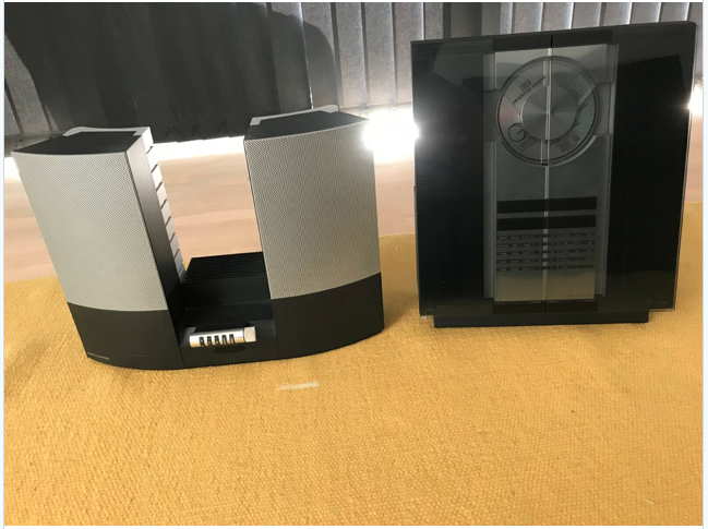

I am trying to help my mother-in-law with a problem with her Beosound 3000, however I'm in no way familiar with any b&o products.
Her system is comprised of these units as far as I can tell (see picture, btw picture was found online):
On the beosound 3000 both the red and green status light are turned on, and the B3000 doesn't react to neither the remote controller nor the builtin keypad. The only button that does anything is the load cd mechanism.
I can turn on the B3000 from the remote unit and control the CD, but the systems shuts down in a few minutes.
I have tried pressing the timer button numerous times, I have disconnected the remote unit from the B3000, and I have had the power off from the wall outlet for about 10 minutes, all to no avail.
Any ideas?
