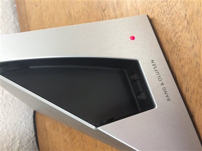

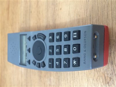

Firstly, why does my Beocom 6000 Mk2 appear to have the Mk1 charging connectors?

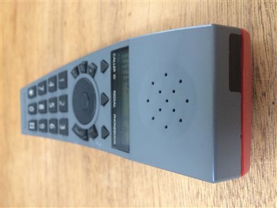

Secondly, why is there no headphone socket?
And thirdly, why does my Mk 1 PSTN base/charger output 5.65V rather than the 7.5V that I expected? Was there a SW change that reduced the output voltage to suit the later phones
Answering my own post - I just found a post of Keith's from Aug 07 that answers my last question:
...in practice and certainly in the UK Mark I and II chargers produce an unloaded charging voltage of 5.6 volts and the phones have the standard 3.6 volts cells made up of three 1.2 volt cells.
Thread here: https://archivedarchivedforum2.beoworld.org/forums/t/3160.aspx
And now I have just answered my other questions, again with information that Keith posted back in 2007: https://archivedarchivedforum2.beoworld.org/forums/p/3222/25165.aspx#25165
It appears that my Beocom Mk2 is actually an upgraded Mk1 - which means that it kept the Mk1 power connectors and did not gain an earset socket.
