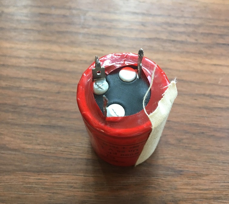

Crystalboy Posted: Mon, Aug 26 2019 5:20 PM
I'm looking for two replacement output capacitors for a Beomaster 1000. It's 3000uF, and has three legs. Can I replace them with capicotrs that has the standard two legs, or do I have to do some alterations on the circuit board to make it work? Would be grateful if anyone could point me in the right directions for parts.

tournedos replied on Tue, Aug 27 2019 8:52 AM
Two of the original capacitor’s legs are just connected together. The circuit board may take advantage of this, in which case you will need to add a jumper wire if you replace it with a two legged cap.
As for values, I’m sure a much more common 3300 uF will do.

Dillen replied on Tue, Aug 27 2019 11:40 AM
Only two pins are used.
The third pin is for mechanical stability.
Take a look at the circuitboard traces. You will see, that one pin has a solder pad with no connected traces.

Thanks a lot for the information! Had time to replace the caps yesterday and now it works like a charm. Replaced it with a couple of 3300uF. But noticed that my Beovox 1000 speakers probably need replacement crossover caps too, the treble on one of them oscillates between fine to muffled. The other one is always fine. This occurs with the one speaker on both channels so hasn’t anything to do with the receiver. I guess the way to go is from the front through the midrange speaker? Any of you helpful folks know the values of the caps off hand? Gonna have time to disassemble this weekend but would be nice to buy the caps before that. Or should I look for something else as the source for my faulty speaker?
