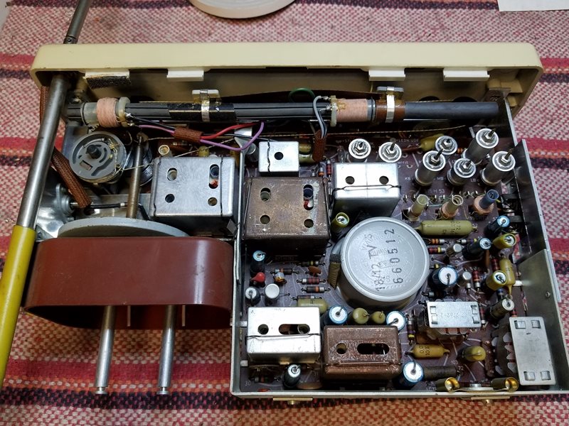

My aunt gifted me this Beolit 600 a couple of years ago, it has been standing on my desk for a couple of years, as the antenna was broken I have been looking for the same for quiet some time, Henrik (Square4) found one in DK and gave it to me on my last visit. Thank you Henrik.

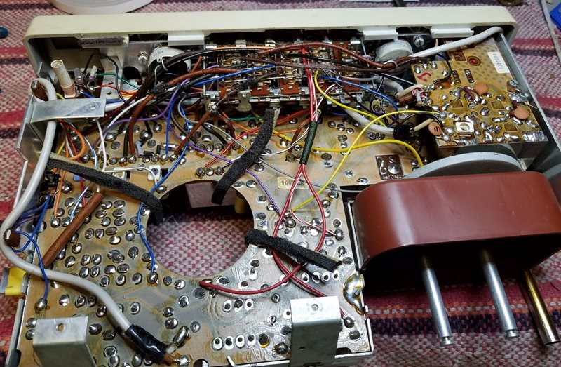

I opened it up, found some oxidation on a couple of covers, apart from some dust it looks very clean, someone has been inside there before me but solder points looks untouched.. Before opening I put the 6 batteries into it and turned it on, no reaction what so ever, will investigate when time allows

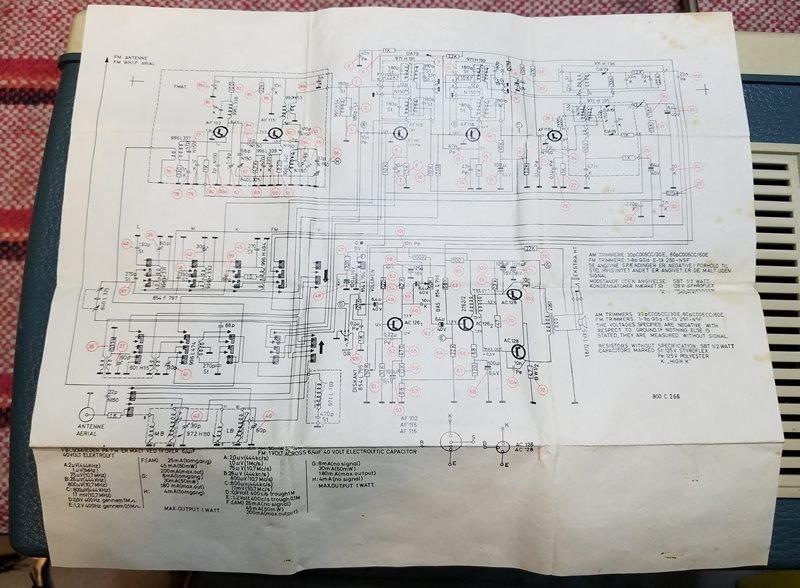

Thank you Martin, only my laziness forced me to ask for a kit Laughing, i will continue looking for failures before ordering new parts, when I have the AF 116 desoldered I will check and if needed try the cap trick, and if I get the unit working, change them later, I have sufficient caps and trimmers in stock to get started. Its a PIB to start up again after doing nothing for couple of years, had to read up on germanium transistors and study drawings again and again, my old brain is not what it used to be

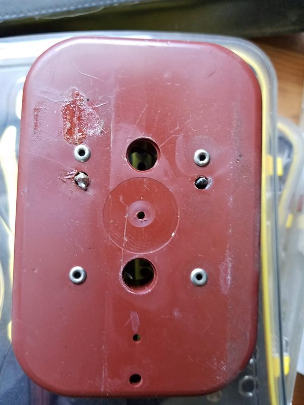

Going very slow here, got the battery housing out, negative pole soldered wire that goes to the on/off button, the positive side just pressed against the steel frame

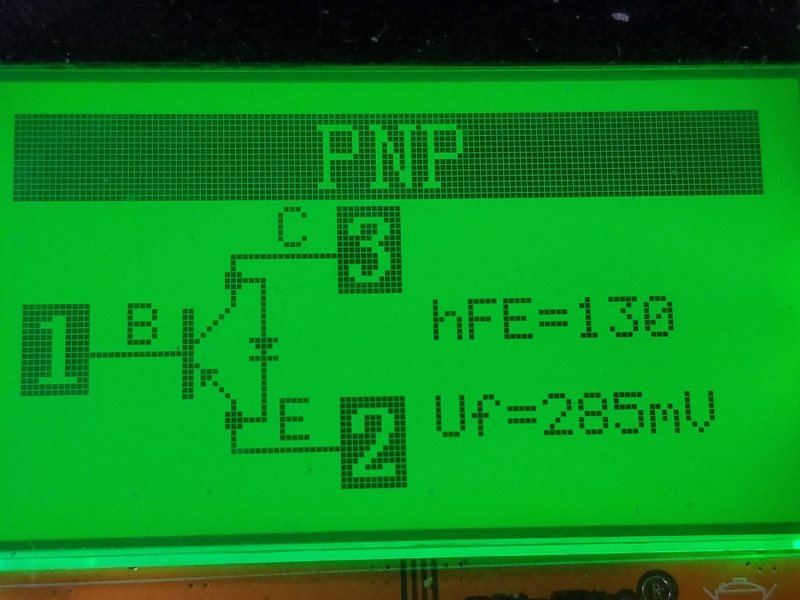

Desoldered one AF116, from B C E to case measured M ohms, in my transistor tester this, right or not at least it shows a transistor
