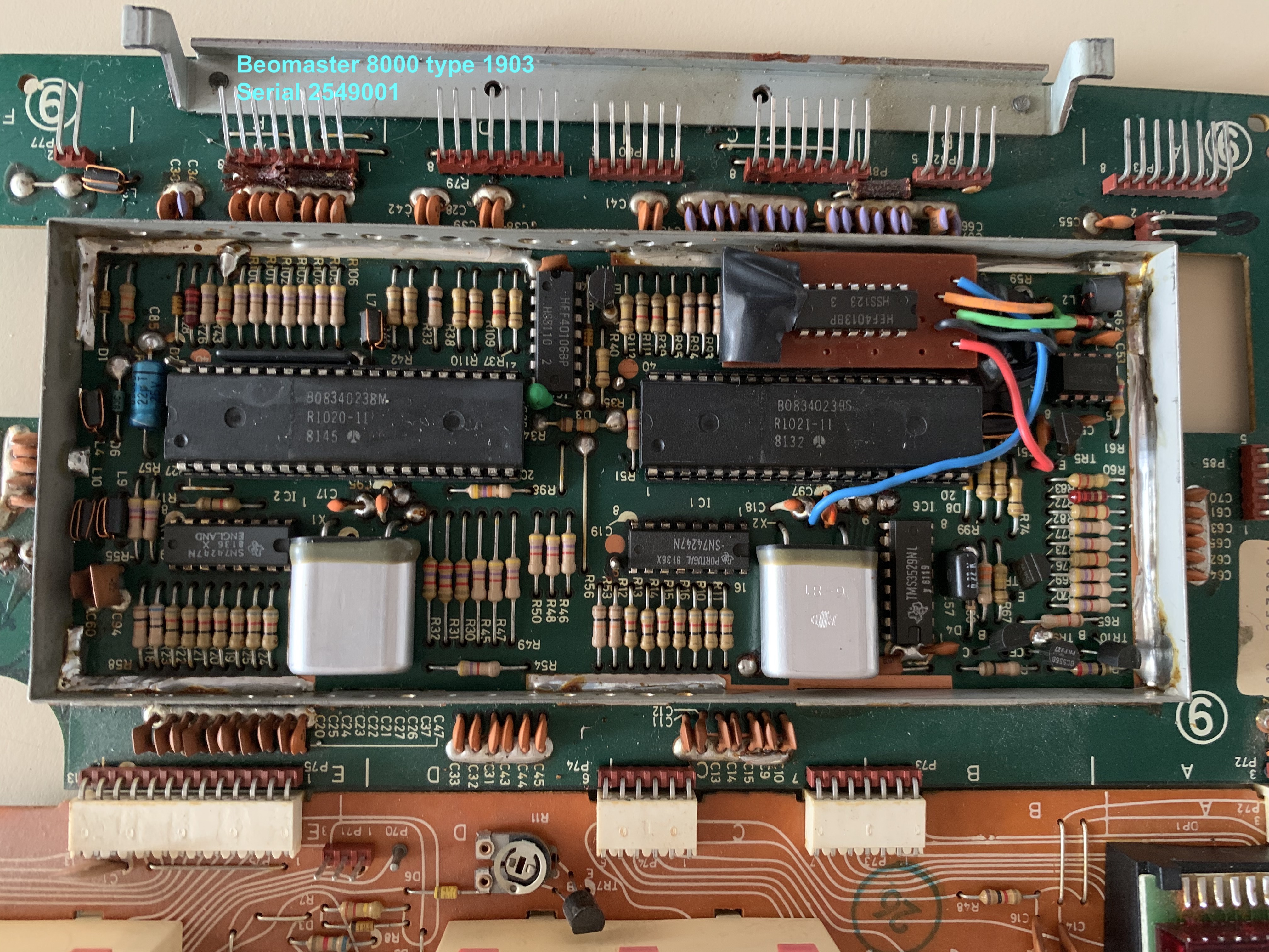

Hi,In restoring quite a few Beomaster 8000 units over the last few years I have seen Beomaster 8000 Microcomputer boards with different parts. Most of those differences are documented and expected. However, there is one change that I don't have any documentation for...The "slave" processor, 9IC4 is usually identified as part number B08340239S (as seen in the attached photo). I have come across several Microcomputer boards where 9IC4 is marked with a part number as B08340265S. The boards appear to work the same but I am wondering if the new B08340265S firmware is different.Note that all of the boards where I have come across the updated 9IC4 have been from Beomaster 8000 USA models. I am wondering if any European Beomaster 8000 owners have Microcomputer boards with 9IC4 part numbers B08340265S?

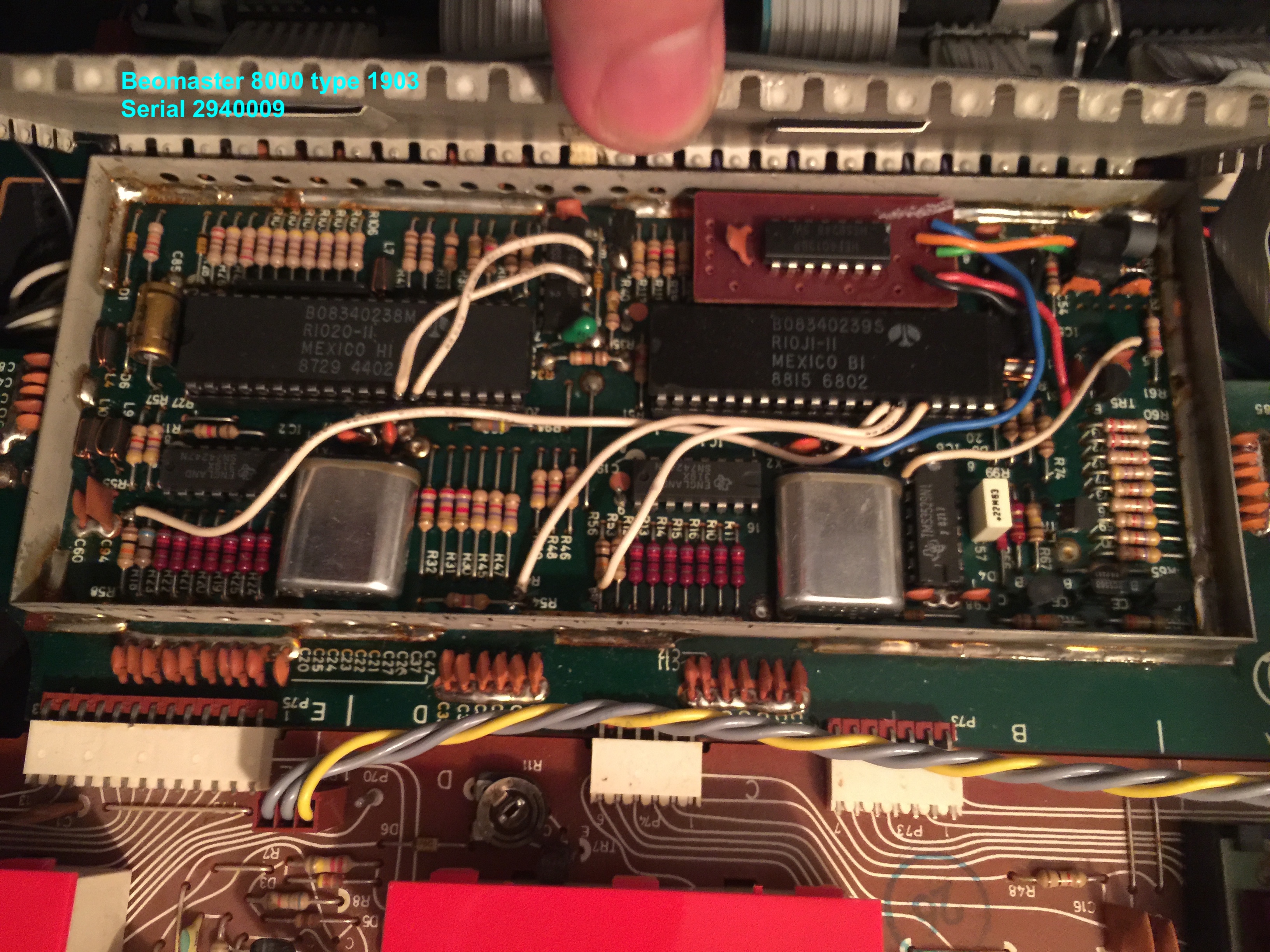

Here is a photo of two different Beomaster 8000 Microcomputer boards (the early version and the later version). It also shows the two different 9IC4 part numbers.

It has the expected B&O original B08340239S for 9IC4. Hopefully some other owners in the Europe market can see if anyone has the B08340265S chip.I suspect is was produced (or licensed to be produced) by B&O as a replacement spare. Having a different part number though makes me think they updated the firmware. I haven't come across any different part numbers for 9IC3 yet. So far they are all B08340238M part numbers.
Did a few work today on my BM8000 in the microcomputer area, so I took the opportunity to take a photo of the IC. I also have a second BM8000 (most recent serial) that I keep for parts (but never took anything out of it since I would prefer repairing it instead.)
A strange thing I notice : on the recent one, jumpers are soldered directly to the ic pins. On my "working" unit, the jumpers are soldered on the back of the PCB...
